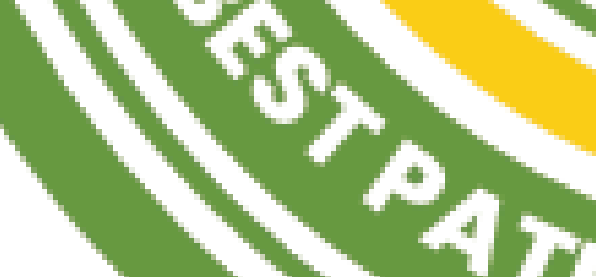

Any tips on this? Customer wants a large sign made from a terrible .jpg or whatever that looks great on their business card or website. I thought it was a brilliant idea to enlarge the image on my screen to approximate what the final size would be, then do a screen clip of a section of the logo, then paste that into an email to them with an explanation. Seemed to me like that would be a foolproof way to help them see how their final product will look. Well, inevitably, the customer replies with, "Why can't I see the whole logo on my screen?"
Y'all have any solutions that are even MORE foolproof?
Here's an example:

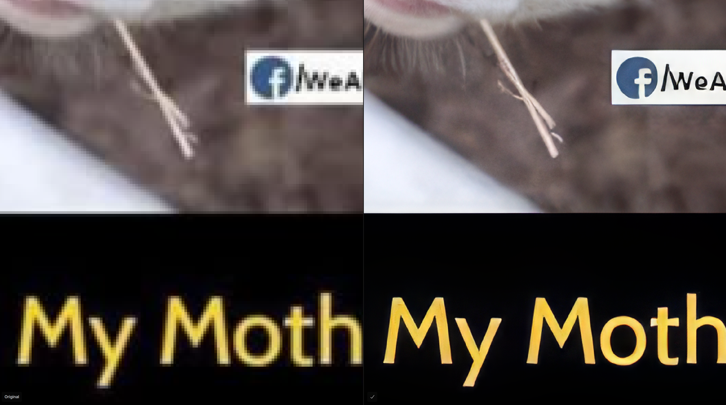

somcalmetim
Ya, try topaz AI, it does a pretty awesome job of upscaling photos...
It does more than just upscale dpi...some of the very small detail goes a lil weird but it does a good job actually reconstructing things...

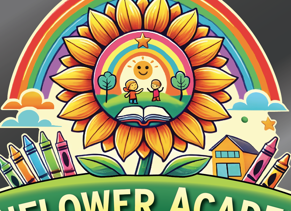

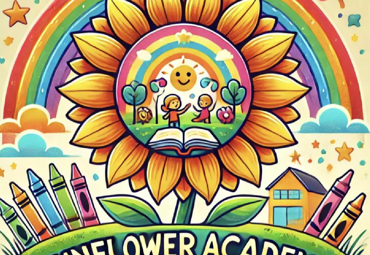

RachelKelly
Just your bright haired sign designer.
In the world of AI generated raster art and people just using free editing software, I get junk like this all the time.
Then after about 4 hours in Photoshop brushing over the shitty details and leveling out some of the weirdness, Here's what their decal will be:
I don't think AI will replace actual artists. It will just piss of the artists in the production fields that will have to continue working with it, and fixing the worst parts of it.
