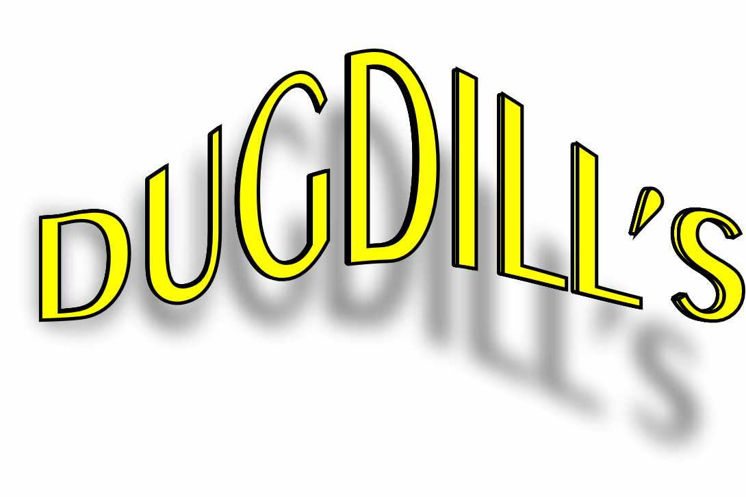

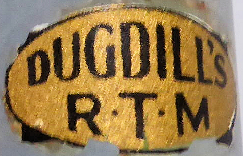

P.S. When i was trying to recreate this old logo i scrolled through the "nearest font" i could find then edited the font bit by bit using such tools as "envelope" in Corel
Original one and my practice one, not prefect but its a start
That old font you just cant find?
l'll be honest, to me that's not even close. :noway: The baseline of the original word DUGDILL'S is straight, not arched like yours. The width of the U vertical lines looks like it should be the same per the original, and the apostrophe is completely the wrong shape. Hard to tell from the photo you have, but the G and the S look to have serifs I think in some other pics in a quick search. I'm nos sure what's going on with the strange double-lines on the ILL'S, trying to make it dimensional?
Not to sound too harsh, but basically, if you're trying to accurately reproduce the original you need to keep working on it. If you're just going with something derivative, well... my comment stays the same. ;)
It's not an easy task to recreate vintage stuff, a lot of those fonts were hand-drawn for starters. That being said, it's a rewarding thing once you finally get it right so keep plugging at it. This is a good and relatively easy one to start with. I'd say find some more source material than just the one photo if it's available. A quick search for "Dugdill's RTM label" netted me a few decent photos. Unfortunately all at angles, BUT maybe you can take bits and pieces from them and make a composite. I work in illustrator, but I'm sure you can do the same in Corel. I like to import the original and stick on the bottom layer and lock it. Then I'll start lettering or drawing on top in a highly contrasting color so I can see what I need to tweak. So like if your letters are black, use a bright blue or bright green or something and then once it's all done set your colors to the proper ones. That makes it a lot easier to see what you're actually working on.

I agree with above. You need to consider that the decal is applied to a curved surface, so the baseline of the top word will be flat. You also need to take into account how the curved surface effects the width of the text. if the decal was laid flat it would be wider than it appears on the photo due to the curve. Also your curve of the top of the letters isn't uniform, it should be one smooth curve from left to right, and it is also much too high.
The L's and I are close, but all the other letters aren't even close+6.
A lot of old 'fonts' aren't actually fonts, so you will never find a match. The most useful thing you can learn to do in Corel is to recreate letters from scratch using rectangles, curves and ellipses.
It is all a learning process though, so the more you practice the easier it gets.
adamfromayr
CHILL out LOL
It wasn't meant to be close it even has shadows it was closer than that but i continued messing around with it
Adam can do much better Adam will do much better

This is the hardest font to recreate as its curved I dived into the deep end on this font
Maybe i will practice on something easier first!
That image i showed wasn't meant to be a match it was a bit similar, but then i went overboard messing with it more and more!

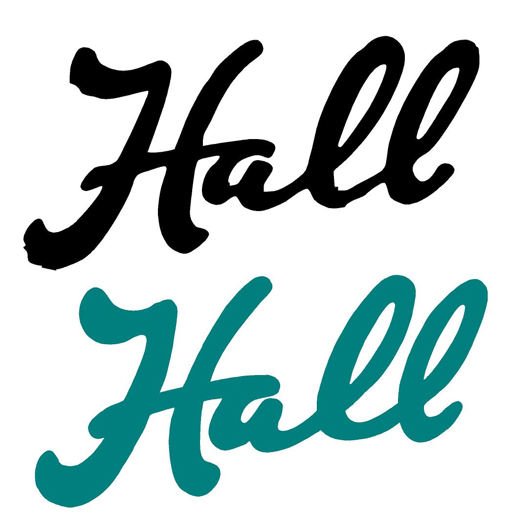

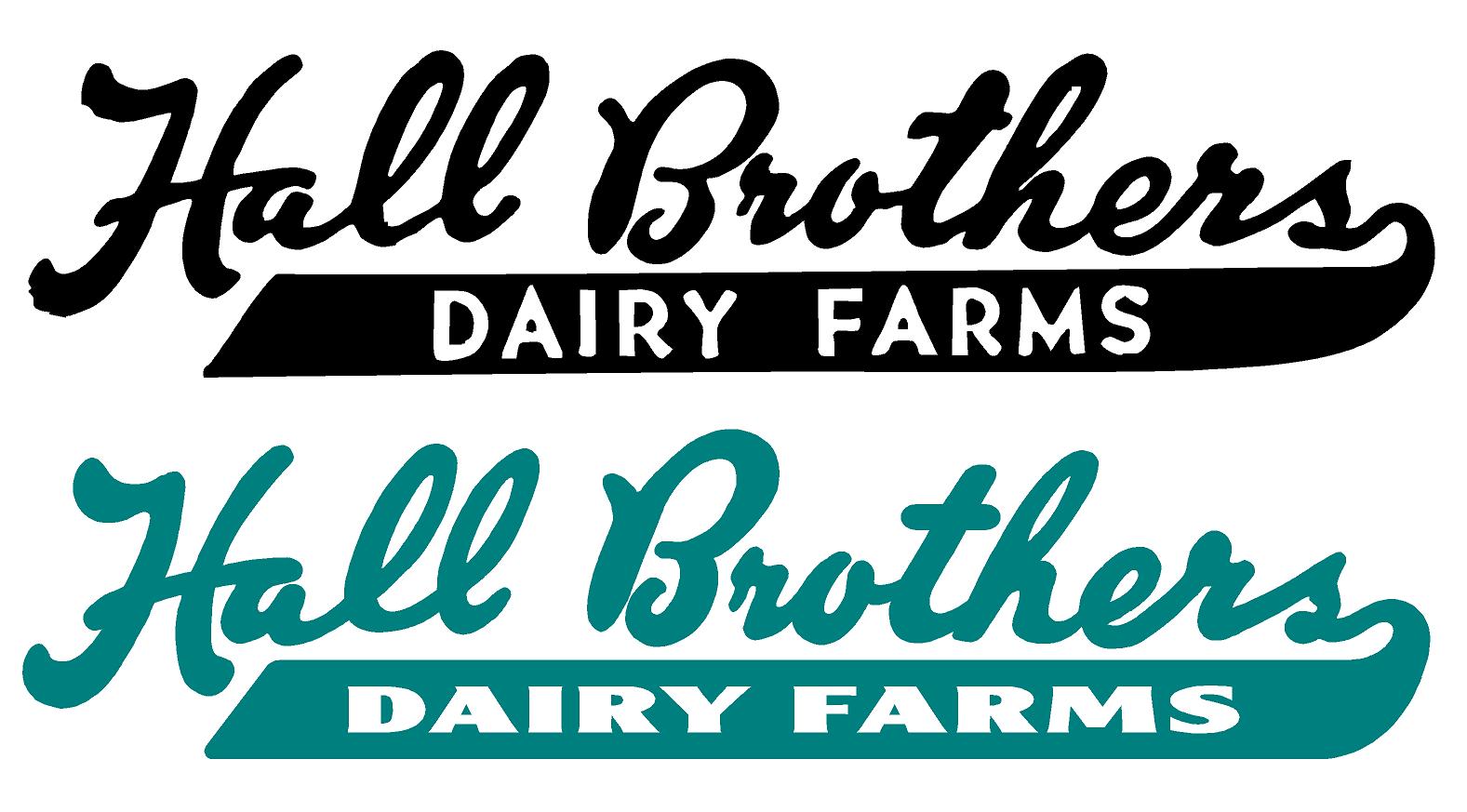

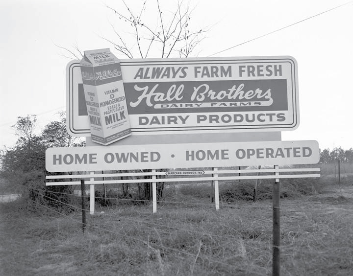

when I reproduce something of this nature I redo the fonts , not as a whole word but each individual letter. It is time consuming but once done, its done. I use flexisign and do a wireframe over the old logos to better manipulate. My dad worked at the dairy below and I vectored that logo off a bill board I was able to grab online at dept of archives. The logos were black an orange but later changed to a light teal bcak in 80s...its a lot of work!

I love the old vintage signs and the Hall Brothers one you did

Not even close.

Not even close.
adamfromayr
No need to be cheeky BOB! If you read what i said it was closer i just uploaded it for the sake of it i didnt ask for peoples opinions if it was close! i know myself i made it and can see its not a replica

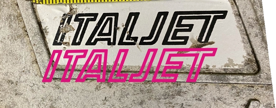

Most simple ish text logos I can do in under an hour with a half decent copy to work from. This logo was done from scratch and probably took about 40 minutes. You do get a lot quicker the more you do them though.
I normally find it easier just to work from scratch rather than trying to autotrace and then tidy it up as it never gives as good a result as making up original artwork.
Of course the customer is always charged for the design setup time :)
