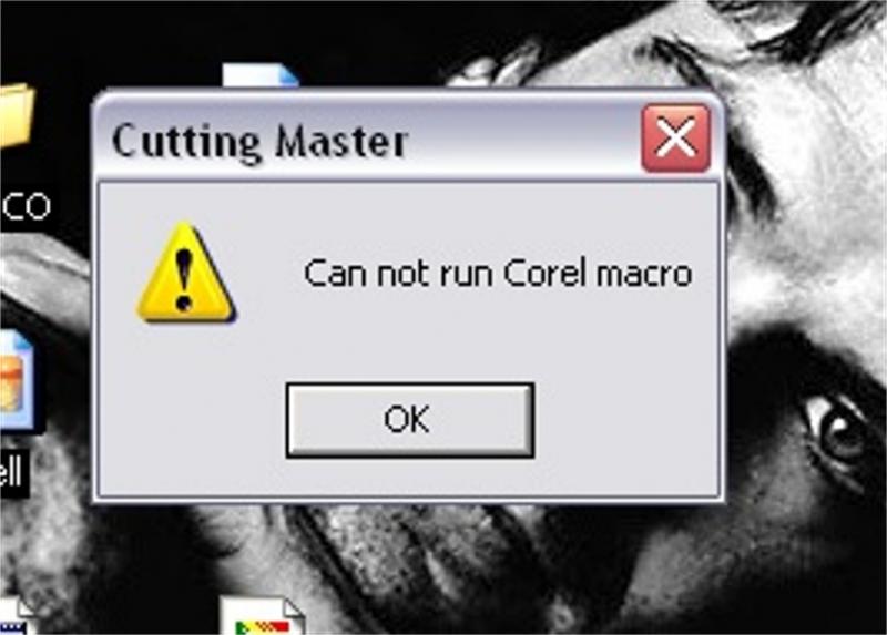

I have an old file which I created in GA6.2 in 2004.
I can export it into Corel.

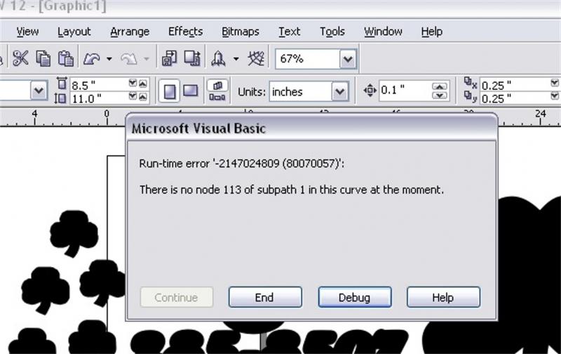

But when I sent it to the plotter, I get this message about node subpath
(pic #1)
Then it either freezes or I close out of Corel and this other message
(pic #2) pops up.

Jill, you have something on a layer that's turned off. Make sure everything you want to send is on the same layer and there are no other layers with ANYTHING on them.
I get that error all the time and it freezes up X3 too.
Delete any layer that's got something on it and it should work.
This is a work around, I'm not sure what the real solution is.

Well whatever you did, Brian, you totally saved my hiney.
Just got it cut.
I feel as if a huge weight has been lifted from me, been p!ssing with this stupid little job for about 4 days.
