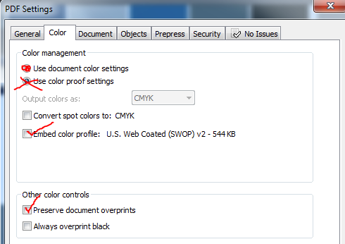

Always best to use Pantone colors and export for print as pdf. Just let corel pick the nearest pantone gray then publish to pdf
jason91
I tried exported just like you posted and it still prints all my greys wrong? I have no clue what the problem is?

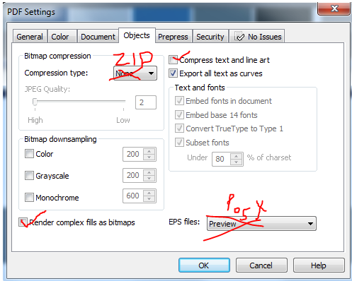

myront
Dammit, make it faster!!
General tab - Acrobat 9.0
myront
Really, compress text and line art? I find that one butchers, horrendously butchers, all vector art. Could just be an artifact with the copy of corel 2019 they keep trying to use around here...
Not sure what relevance that is anyway since fonts are being converted. I could probably uncheck that and never notice any difference. My thought was that it reduced the file size but never really tested that theory.

myront
Here's a recent example I had to fix...
Seriously doubt that the text was caused by the "Compress text and line art" option
As for the image being "chopped". That usually happens when saving a large raster to pdf. Sometimes it can be fixed by selecting all those bitmaps and do a "create bitmap" to "flatten" it.
