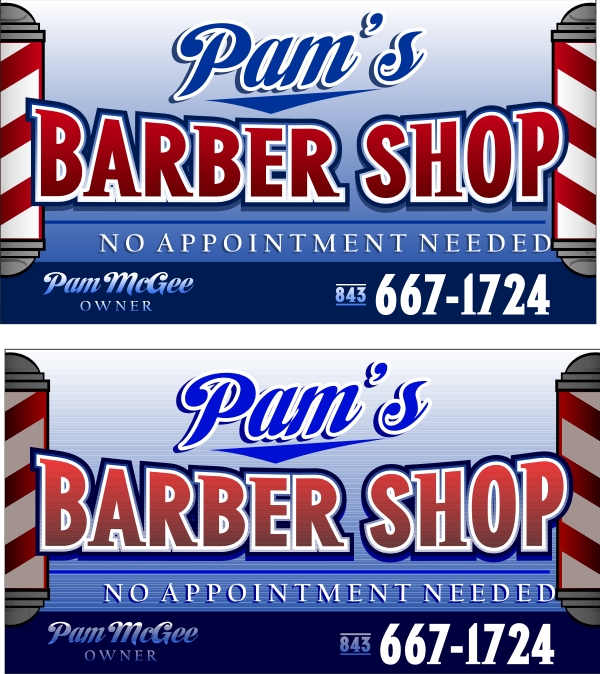

Ok,
Here's an example. Now I'm noticing that the colors aren't too terrible, but all the lines in the gradients are visible in Corel making it seem blurry. What's up with that? In illustrator, it looks fine....
The top is the original, bottom was exported as eps and imported into Corel...

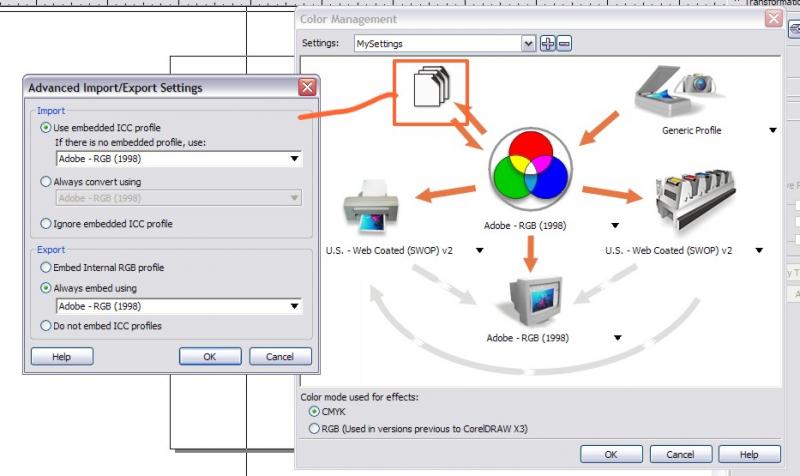

Here are the settings I use, found under "Tools", "Color Management". See if this helps. You might have to do a Google search for the "Adobe-RGB (1998).icm" file, but see if this helps.

Question for you GXSignCo (btw thanks for the useful info) does the Adobe RGB colors in that profile look the same as the Default Corel RGB Colors, because I love the Corel RGB setting, the colors are just so vibrant.

When you create a gradient in Illustrator and save it as an eps and import to CorelDraw, it breaks up the object into individual objects of the same color. (ungroup in corel and click on each one and you'll see what I mean) Try saving in Illustrator as an .ai and import into corel and see if it's better.
Also the gradient in Barber shop looks like it may be from two different color models (Pantone & RGB) In corel, they need to be from the same model or they will look washy like that. It takes a good amount of trial and error to get the settings down when going from program to program.

Question for you GXSignCo (btw thanks for the useful info) does the Adobe RGB colors in that profile look the same as the Default Corel RGB Colors, because I love the Corel RGB setting, the colors are just so vibrant....
I honestly don't know as I've not tried that. Which 'Corel RGB' setting are you specifically referring to?
Joe Diaz
Too be honest with you I like the RGB setting with color management off, unless we need to use specific pantone colors or... like I said, I anticipate the job going to another shop.
For what ever reason, even when we print, we get the most vibrant colors, and gradients are perfect. You know when you do a red to black gradient and you get a gray brown somewhere in the middle. That RGB with color mangment off setting fixes all of that, plus I found it's the best setting for web design. Too bad it sucks when exporting eps's and ai's.
