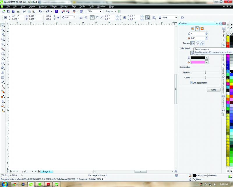

There should be a place to select which type of corner you want in the contour pop-out window. This is X6 in the picture but X5 should have it also.
I'm pretty sure X5 doesn't have that feature, that was new to x6 if I remember right. The way you would handle that in the past is to pre-filllet you shapes before you add the contour.

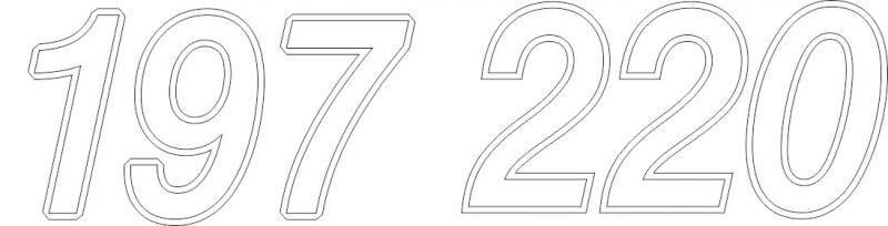

Thanks for the replies. I do have X6 on another computer, but I don't understand why it changes from time to time. And I'm not talking extremely sharp point either, even a 90 degree point will do it. Attached is a picture of some unit numbers I'm working on right now. The one on the left is new, the one on the right is one I did a few months ago. I know there are work arounds, but I'm trying to get it back to where it once was (again). And I know that I haven't changed any preferences or settings on this particular computer in some time.

It shouldn't be doing that, It doesn't for me anyway. Have you zoomed in real close and inspected the text with your shape tool to see if there are any extra nodes. Perhaps the corners are like that for that font/text but so small that you cannot see it unless zoomed in. If that's the case deleting those extra nodes manually would do the trick or sometimes you use your shape tool and "select all nodes" then select "reduce nodes".
What font is that? Is it just Arial?
Yes sir.
