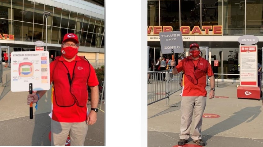

Hi everyone, urgent request here. Does anyone have any vendor suggestions for a coroplast handle or something similar to this photo attached? Flutes got printed horizontally, so it can't be a wire holder.
This is for an event next Thursday and I need about 180-200 pieces in the $1-$5.50 per unit range with shipping.
Thanks gang!

Or even easier. Get some cheap spatulas' from ebay put some double stick tape on em and your good to go

We buy aluminum tubing .. cut it to size, throw a cheap bike handle on it and rivet it in. Really cheap to make yourself if you can cut the tubing up and slice a line down the too for the Coro to fit into.... Not sure of any vendors who sell them.

https://trafficsafetyzone.com/product/stop-and-slow-paddle-replacement-handle/ You could contact these guys, see if they sell both parts... Probably get a decent discount when buying 100 of them.
https://trafficsafetyzone.com/wp-content/uploads/2019/04/paddle_short_handle_SSP12HANDLE.3.png Pretty good idea. Not sure if they sell the top part though.
I don't have grimco.com login info, so I can't see pricing... But they sell handles as well.
https://www.grimco.com/Catalog/Products/StopSlowPaddleHandles
All it is is a dowel with 2 holes in it... You can buy 8 FT of dowel for like $5, if you have the capability it's easy to cut them up... I'd put a slit down the center of the top and fit the coro into it for more stability though.
