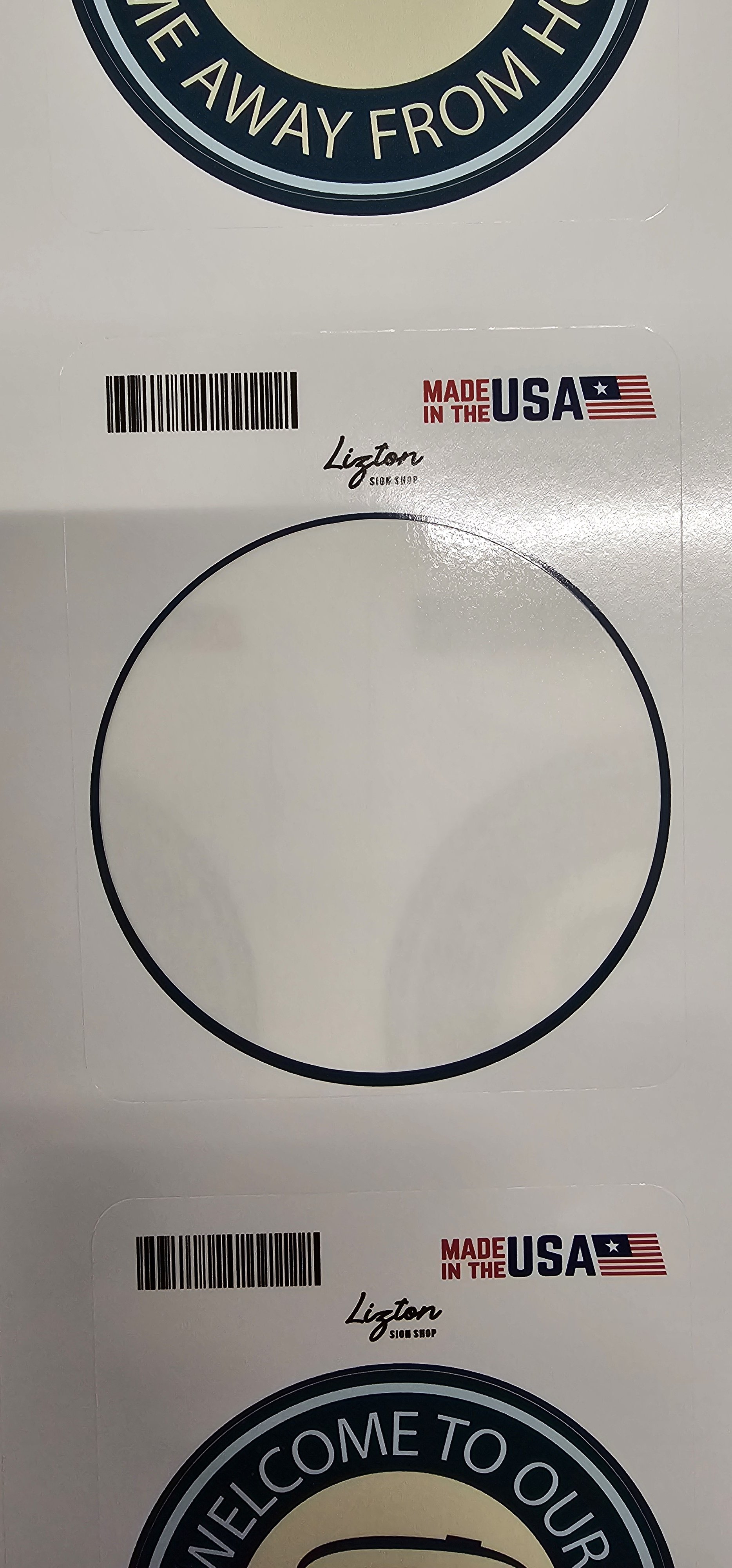

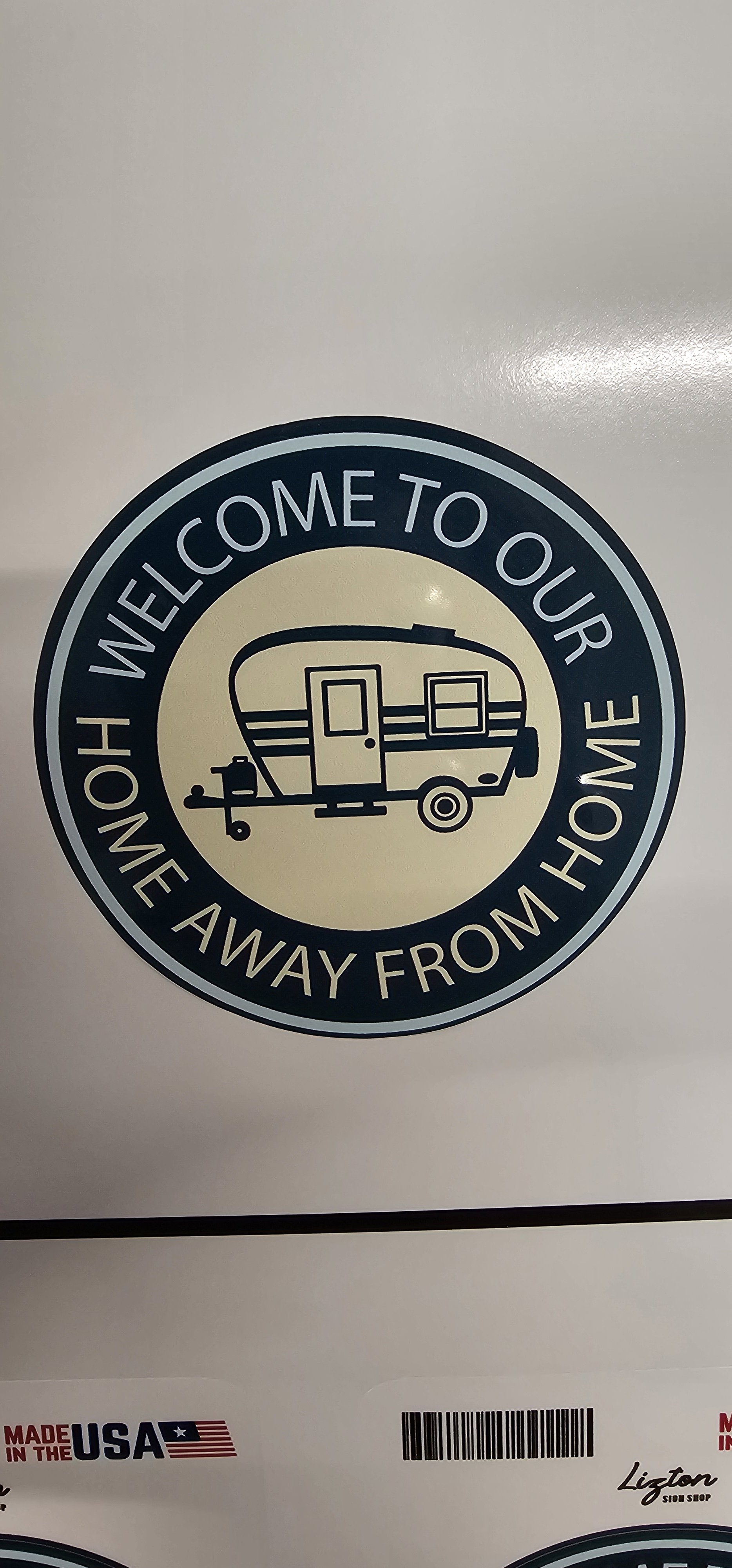

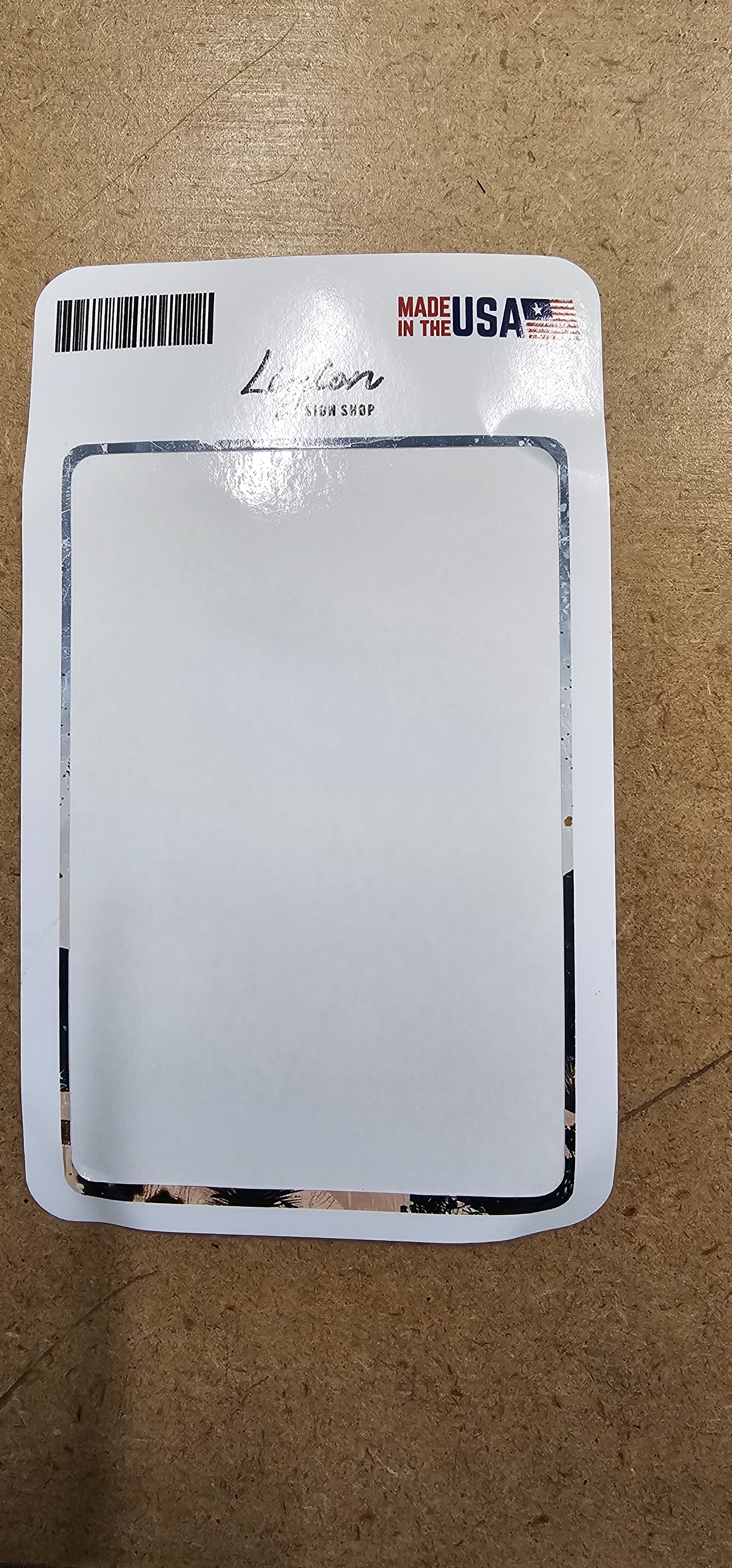

Ok as promised here is a link to video. https://www.dropbox.com/scl/fi/6ttt...ey=797xnvyg2r26w56ug674cacj3&st=leaw6n5i&dl=0
I will also attach some images. I have included another circle similar to the ones in the video and then I also attached a rectangle and on the rectangle I have gone back to the Illustrator file and the kiss cut was aligned perfectly in the art do again I am not sure why there is more art bleeding out the bottom vs on the top.
I have a secondary problem with my newest file where for whatever reason the kiss cut appears to be cutting once in one direction and then cuts the same path in the ooposite direction. Then when it does the perf flex cut it does it once and then cuts it again and removes all the perf tabs and the stickers then basically falls out and in some cases jams the cutter. I have gone back and checked the design file in illustrator, spot color is good, stroke is at .1 pt, this one has me scratching my head and it is doing it on the rectangular sticker you see in the images attached. Should also say that i have tried it with the middle pinch rollers down and with them up. Also I should mention overall the issues seem to be in the middle by the middle pinch rollers and towards the outside rollers the cuts seem better

Watched video, Can you add additional registration marks on the width of the roll? I know on my Graphtec I need more registration marks than that and use the XY segmented area marks
Thin borders on round stickers can be a pain

Do you have it set on default speeds? Slow it completely down from cutter control and see how it affects that. You can also print multiple rows at a time so it's easier to test. You could have had maybe 4 rows on that piece of vinyl.
For the double cut. If you didn't change any settings then your file is faulty.
If it's checking the black line with the marks then you already have it set for OPOS XY which is accurate enough.
And check your print with a straight edge just to see that what you are after for. If it's not straight to begin with then the cutter needs to compensate. That makes things more complicated on long runs.
