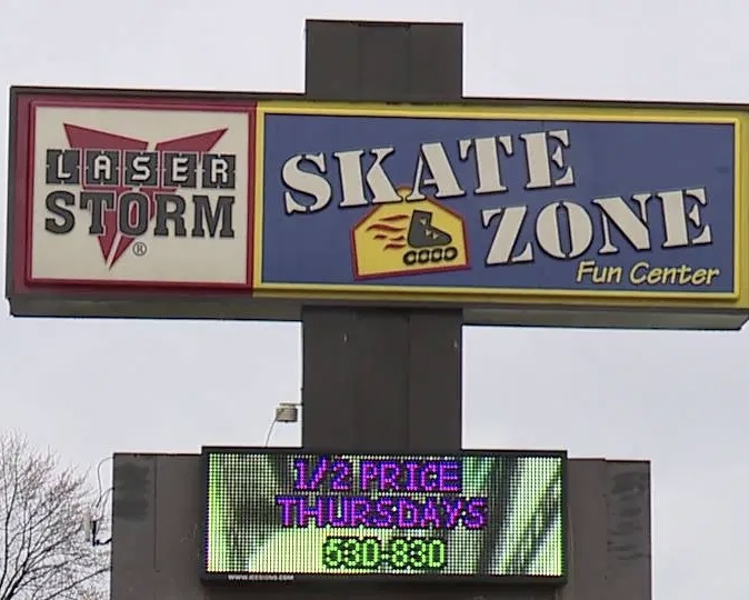

A customer of mine is redeveloping a property and they want to temporarily cover the existing pylon sign while it is under construction. What would be the best solution for covering up both sides?
Johnny Best
Just get two banners a little larger than the cabinets and have grommets all the way around and lace them together with black rope that awning companies use so it does not rot. WYLDGFI can print them for you.
There are two single face cabinets with a pylon going up the middle so lacing them would be easier.
