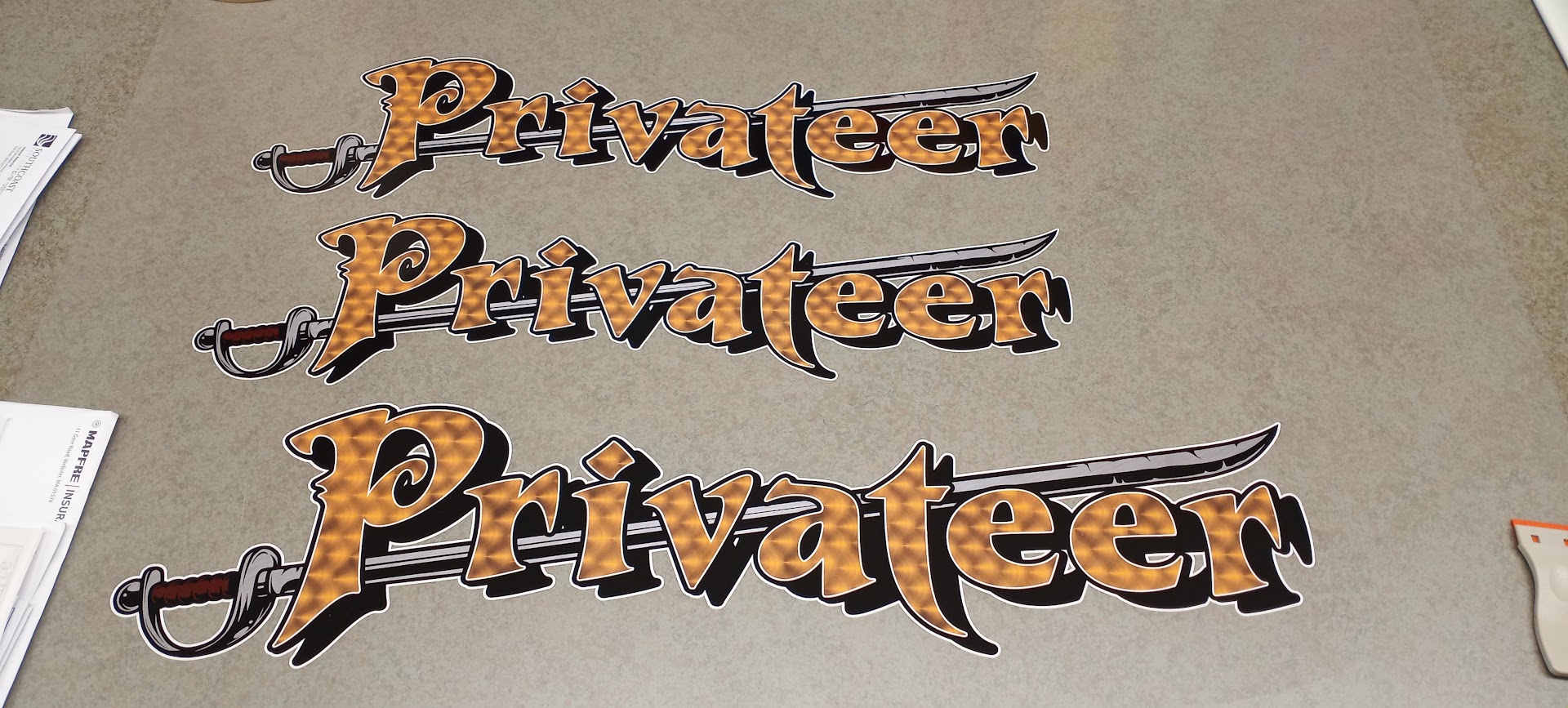

Gary1
SignLab has a fill thats large and small engine turn. I’ve used it a few times and it look good. I’ve even taken a photo of Quick Gold and used that as a fill in SignLab and it also turned out nice.
