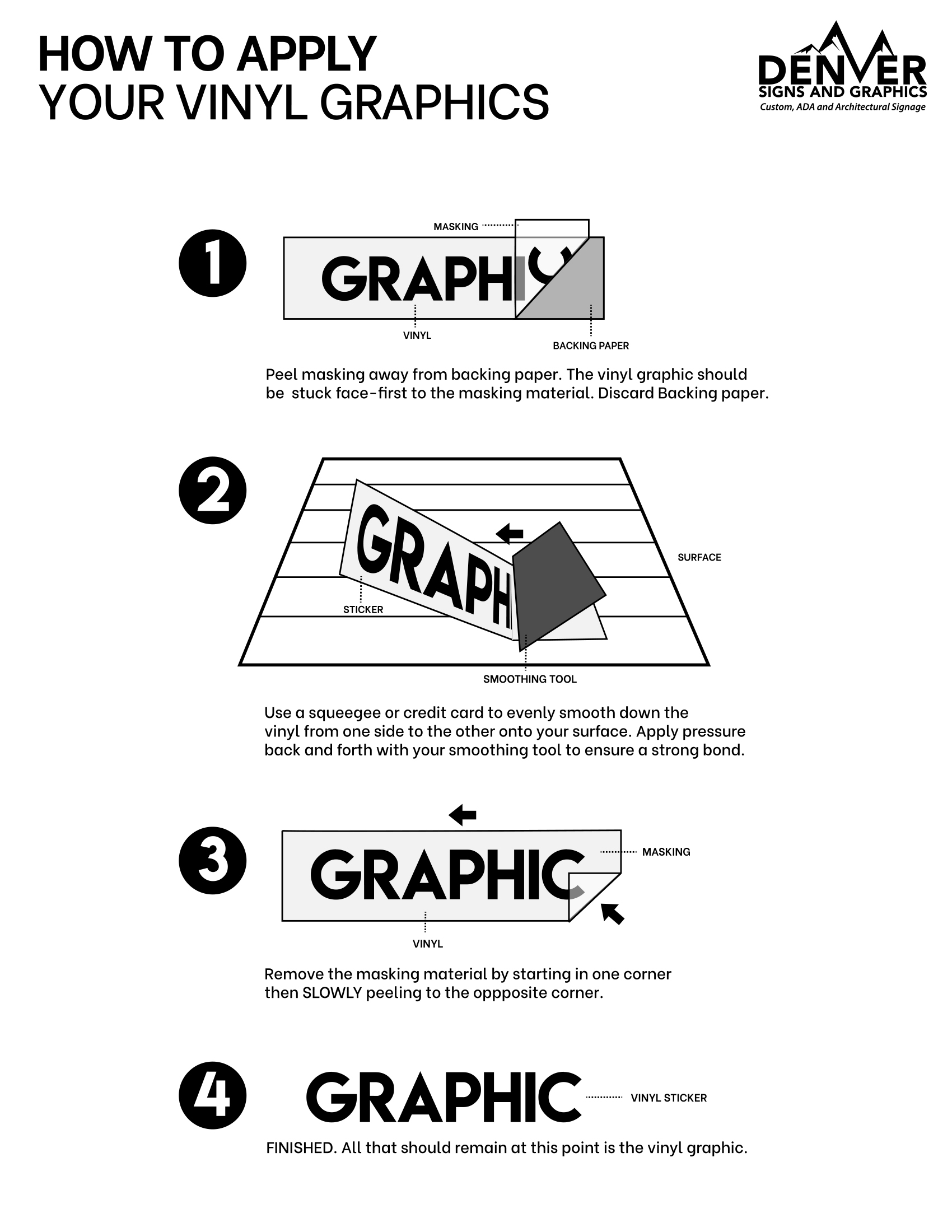

I found these set on instructions on a website. Pretty helpful to give to customers. You can design it up and put it on your own "letter head" and give it to your customers with their vinyl to install.
Hope this helps..

I made this to give to customers that don't want to pay for installations. More than half the time they screw it up and come back to reorder AND pay for installation.

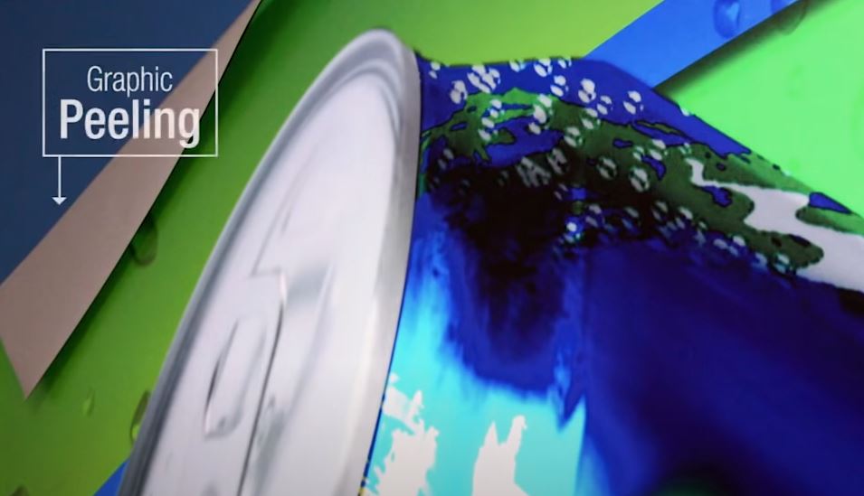

I would say that prepping the surface is something your instructions should have more clarity on. If they wrinkle to vinyl, or tear it, it's not hard to understand that was their fault. But if they apply it smooth, and it falls off a few days later, or starts to peel, you'll have a harder time convicting them that it's not necessarily the adhesive's fault.
Here's info from 3M on wall prep and testing. Same concept for other surfaces too:
truckgraphics
I always heard that Windex was bad for vinyl adhesive, so never use it except on glass, where it cleans very well as claimed.
Maybe that's an old wives tale, but I have stuck with it.

Mine is almost the same as Abraxas. Bullet points and photos are always best, people don't have long attention spans. Also, a video on your website with a QR code would be perfect...I always planned to do that LOL
