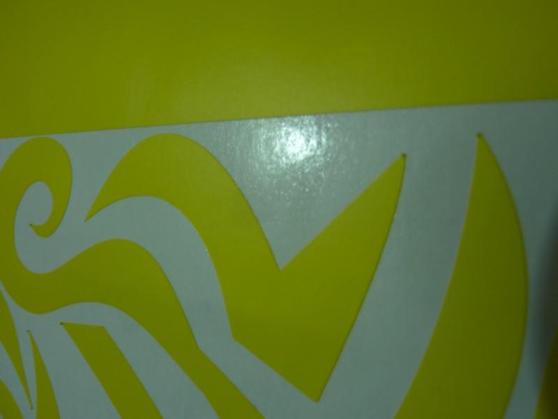

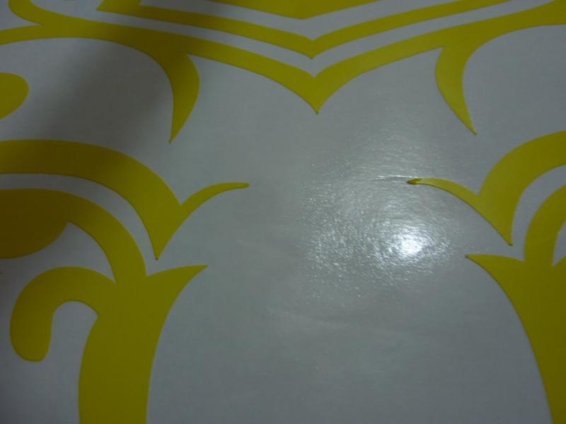

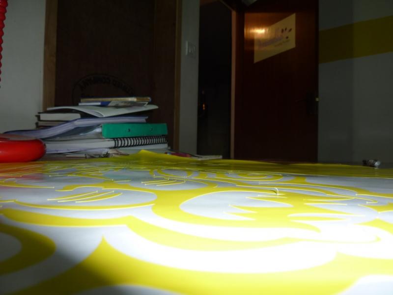

Hi,
I am facing issues with the cutting in my machine (VP 540i). The cutting performs dots (more like a tear than a cut) and especially in the corners it is more pronounced (big dots at sharp corners). I have replaced the blade and the blade holder. Both did not work.
I am not finding the solution anywhere.:help Please suggest if you have come across anything like this and any solution would be great.

Mike_Koval
try a different offset...default is .250. perform a test cut, if the square is rounded, your offset is too low...if there are horns on the corners it is too high
NotAPrinter
Another solution...
In my limited experience, this can be caused by the cutting head moving faster than the swivel blade can adjust. Try slowing the speed of the cuthead.
Tony McD
....or the teflon cutting strip on the machine.
If you can see or feel a groove in it, that could cause skipping.

deegrafix
I had that problem as well, and now cut at the slowest speed, which is still fast enough for me, and no more skipping.
Fatboy
I know you just changed the blade...just make sure they didn't sold you a bad blade. Happens when it falls.

I was having the same problem with certain media/lam combos mainly the cheaper thicker materials.On certain corners it seemed as if the blade ripped the vinyl and other corners it was like the blade would skip about a 16th an inch ,...believe it or not after playing with different pressure settings i found dropping the pressure ended up solving my cutting issue.
I find cutting material is almost like a guessing game.until you get use to the different materials, here's an example...I was afraid the blade wouldn't cut through the media so I started at a pressure of 168,it cut through but had that ripping problem so i kept increasing the pressure.I think i got up to 212 still had the problem. So i starting dropping it ,my magic number ended up be 143
Check your blade holder... may be worn out.
Change the blade ... may be broken or worn.
Change the Cut Strip ...may be worn from usage
If you're using a 45 degree blade - .250 setting...with a 60degree .500 setting
Check cut pressure...new blade setting is "around" 120 grams force depending on media and/or laminated media.
This should help you out.

a brand new oem blade holder and blade should have fixed it, but what about the cutter strip? Always been one of those three when cutting quality declines.Usually it's the bearings in the blade holder wearing out.

After the new blade, did you re-adjust your settings so that the pressure went back down to the starting point?
Did you blow out the blade holder with air?
How easily does the blade move in the holder "by hand"?
Last time I had this problem I believe I added a drop or two of 3-in-1 oil to the holder and worked it around by hand and some grit/junk came out.
I cut at 10cm/s and cut much better than I used to at faster speeds.
