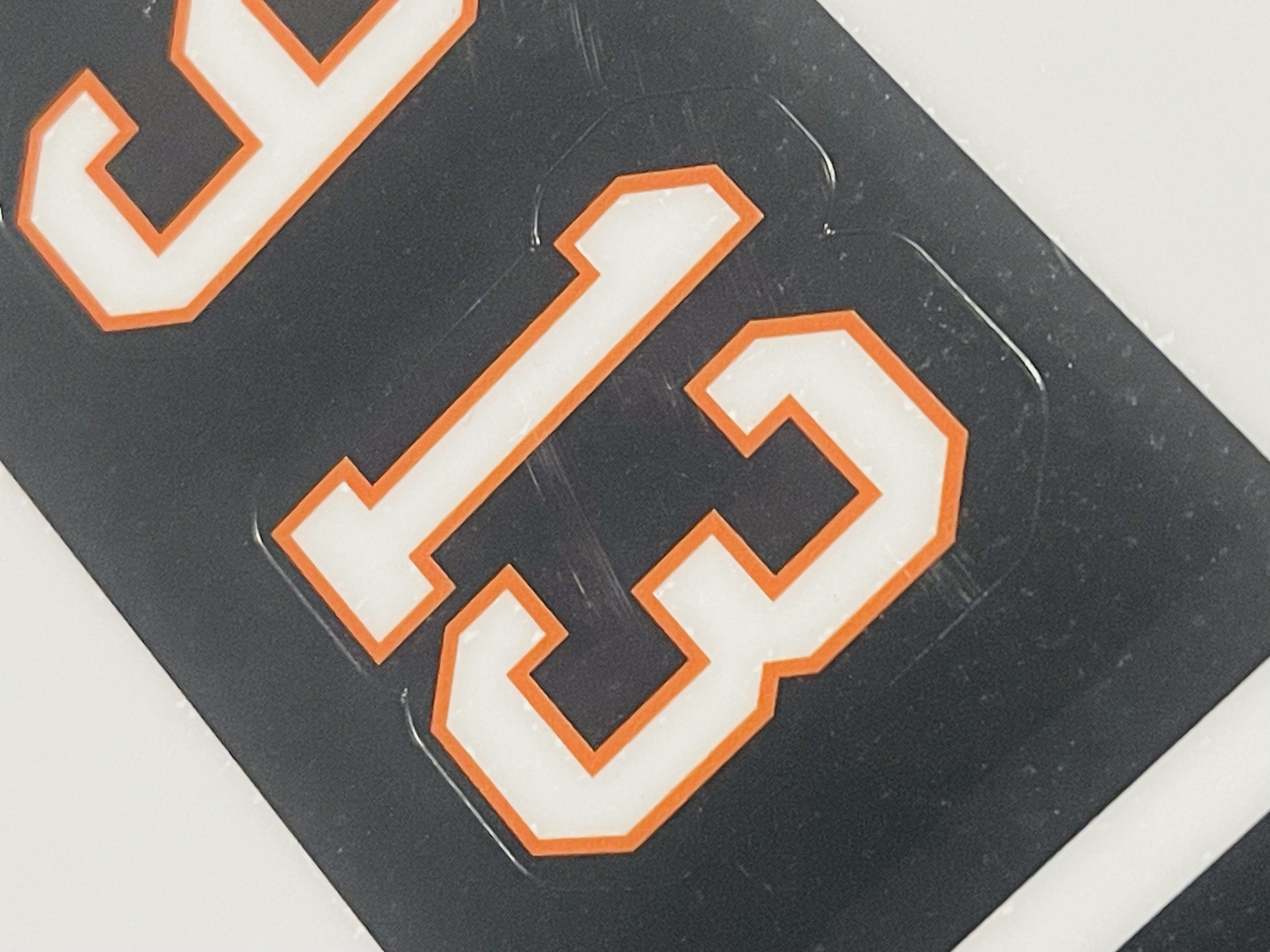

Keep ruining prints - out of nowhere my cut line is “shifted” towards front of machine. It is perfectly aligned as a file - and even on VW when I zoom in cut line is exactly centered.
If I orient the graphic sideways - the cut line is shifted to the right. When graphic is oriented right side up - it is shifted up. So it is shifting the same direction every time.
I’ve done manual cutting options, done advanced cutting options in VW - no difference. Brand new blade - new cut carriage - and cleaned the encoder strip.
I’m running out of ideas and losing business. Any help would be greatly appreciated!
Only thing I can think of is pinch rollers (but other cuts with less force are perfectly fine) - and or the actual small motherboard for the cut carriage. Otherwise I am at the point where I need to look at a Summa for cutting or something to pair with my versacamm. So frustrating. Lots of orders coming up too….

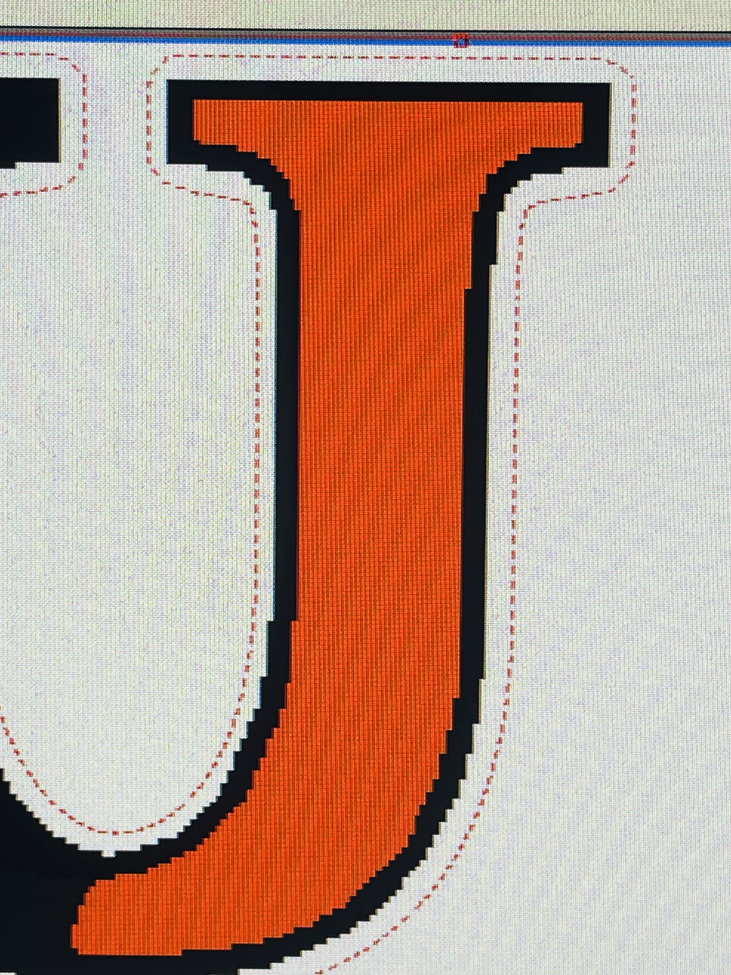

I just tried to reflatten the image and save it again in Illy. Then just did a print/cut all in 1 option on VW without laminating or anything - and cut is still “shifted” the same as before.
Engstrom Graphics
sniperhockeydesigns
This is how VW sees it - and it’s dead on in Illy as well. But result all of the sudden is not.

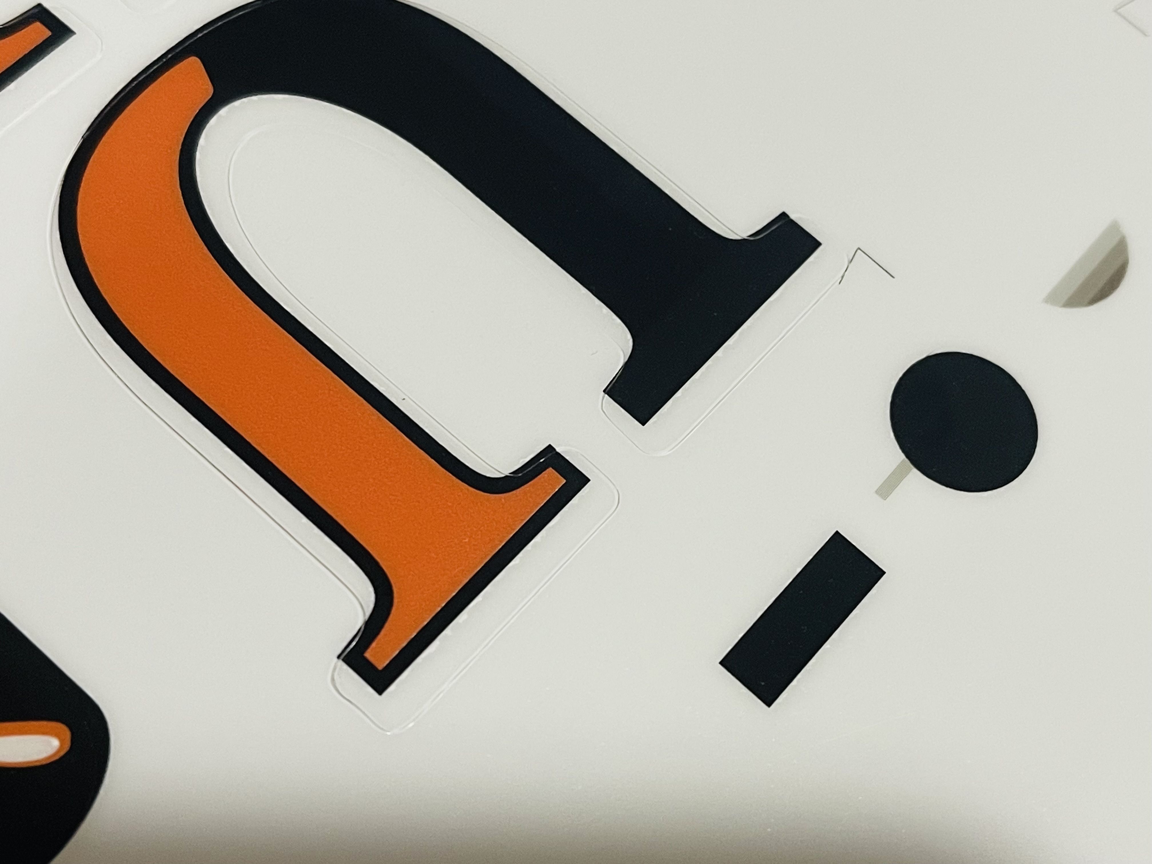

Please help - now I go to cut the same file that I tested yesterday and it was spot on - now cutting jumped again and is off.
Anyone?

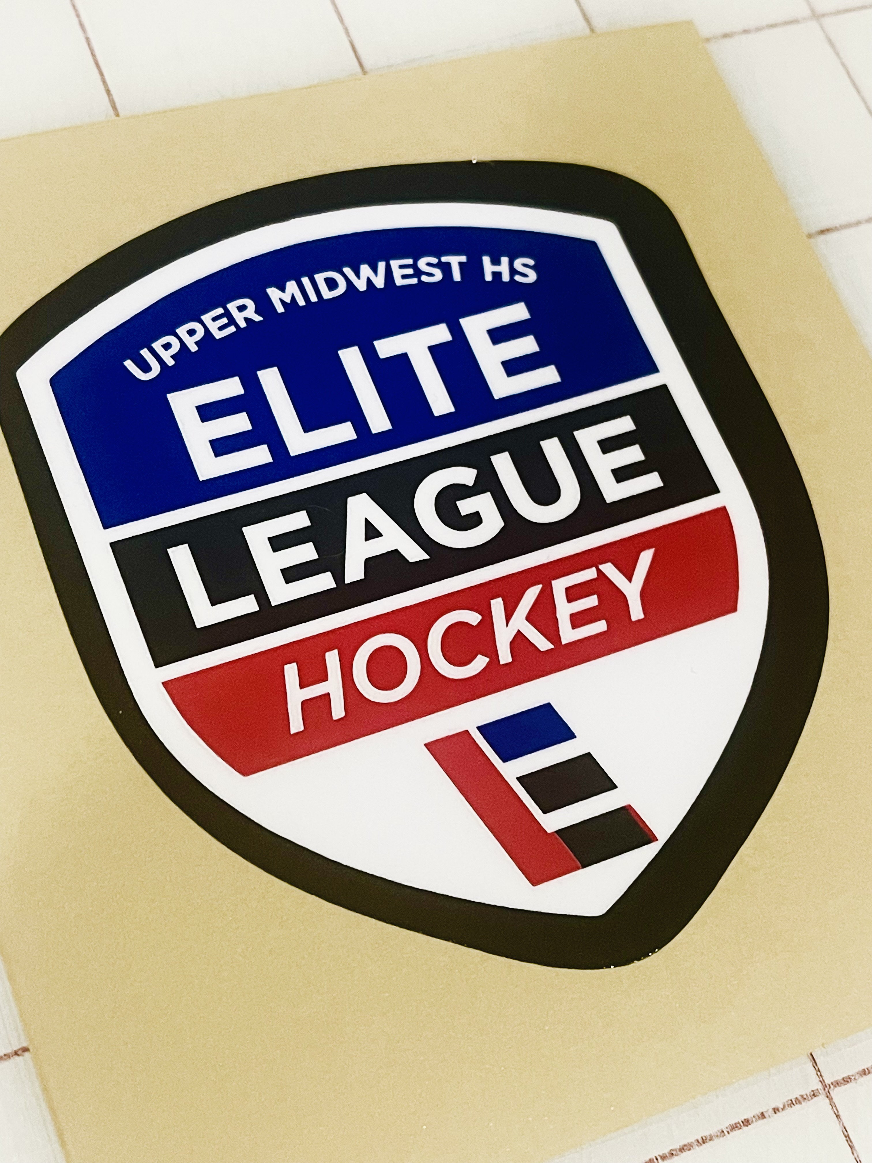

Another sample from today - used thinner laminate, 45 degree blade this time.
I was trying to ascertain if there was a difference between using “Enable Advanced Settings” in VW compared to using the panel on the printer itself - and cut is off regardless.
It’s not feasible to “guess” the print/cut adj setting every time I print and lam - then fingers crossed I guessed correctly on those mm adjustments. It was spot on when I changed those - now next time I cut those print/cut adj settings are off again.
What is going on?
