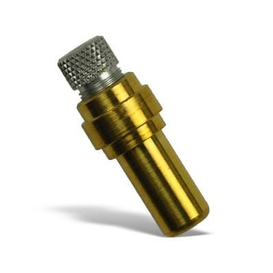

Not sure if this will help but when cutting heavy laminate on my Summa I have a heavy brass blade holder. Adds a lot of weight to the available cut force. That and a 60 degree blade will cut clean through cast vinyl with 10 mil floor lam. might even be heavy laminate than that.
IIRC when I sold my Roland I gave the new owner the brass blade holder.
