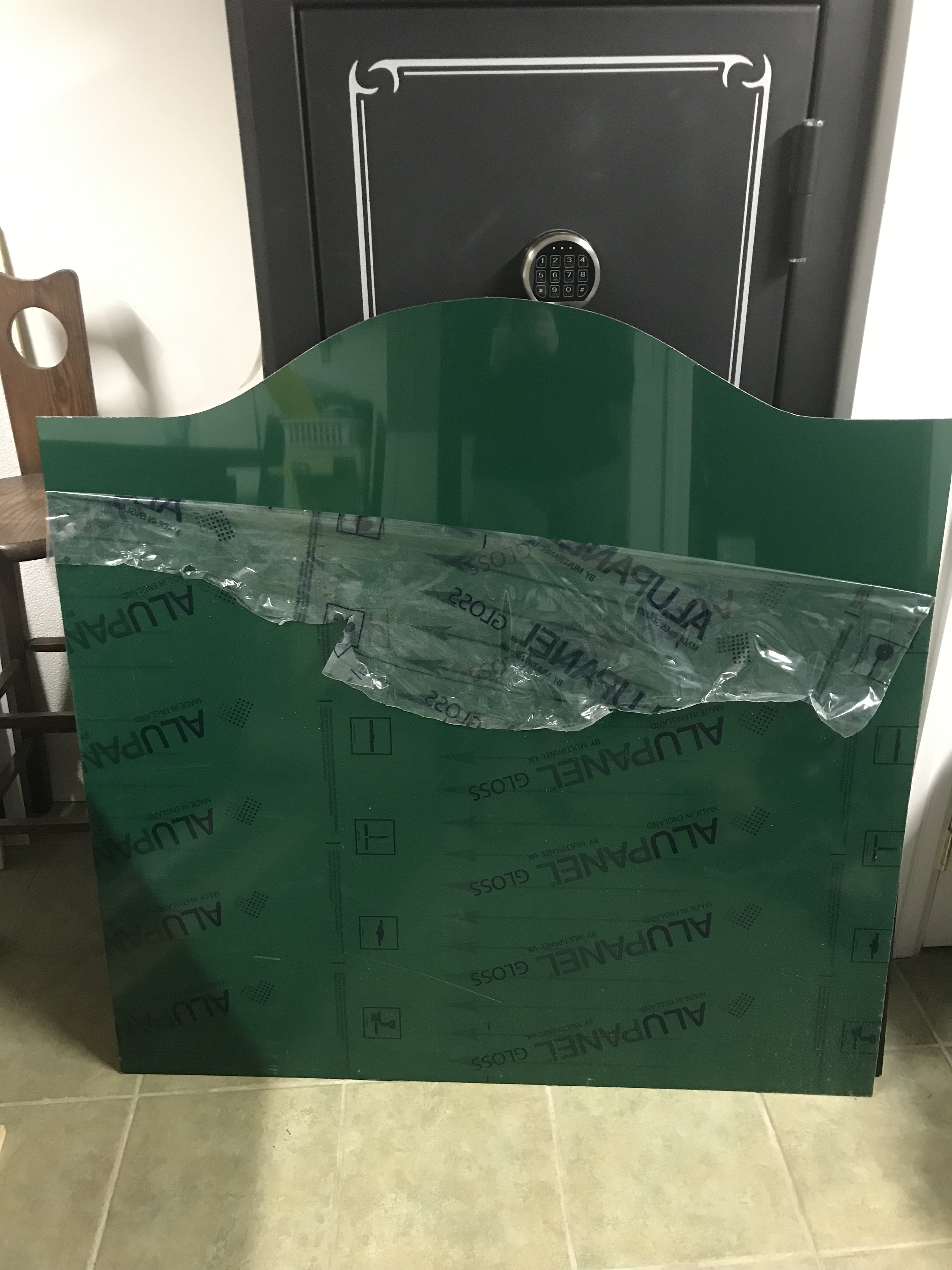

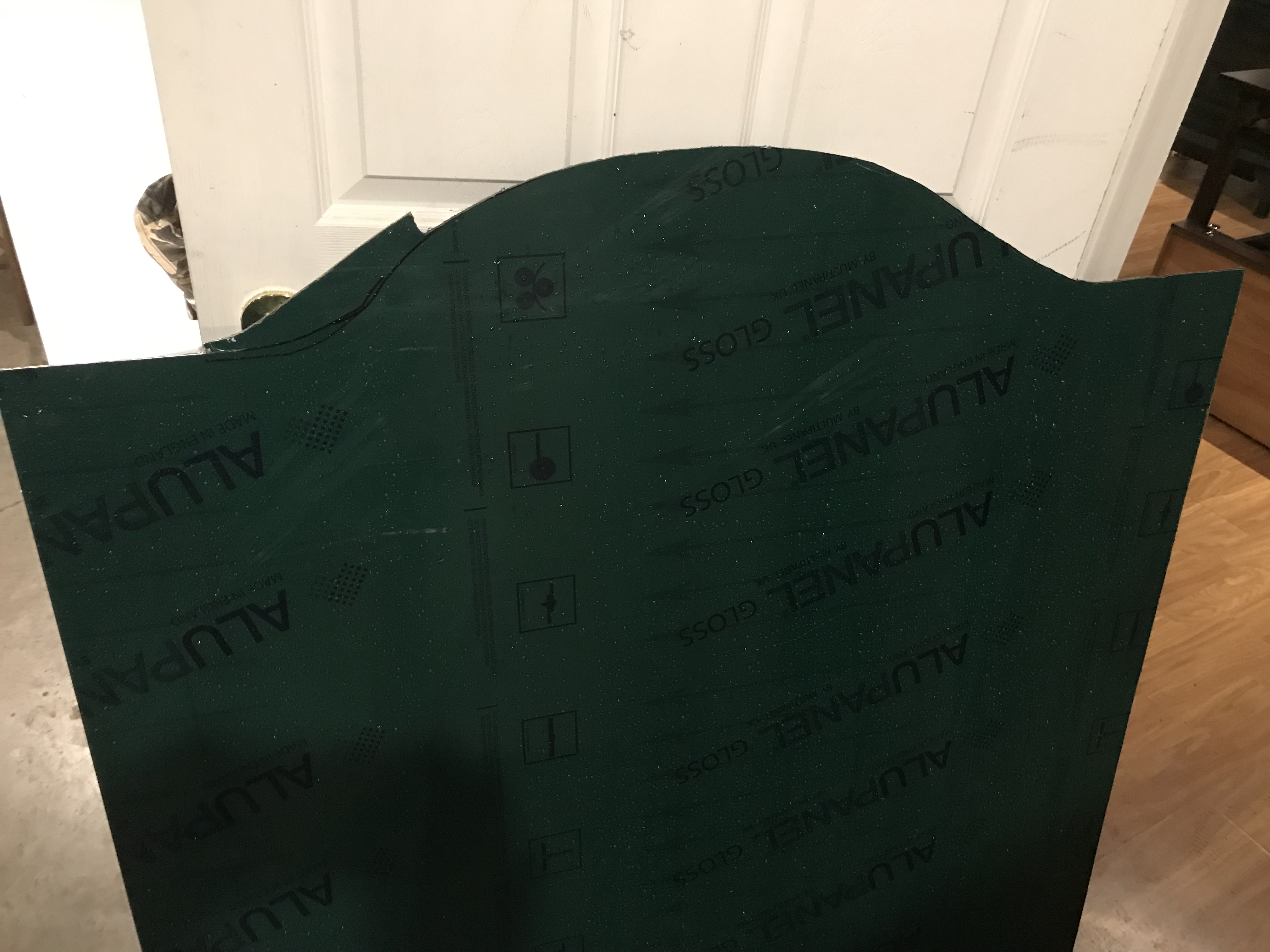

I have a one time cut to make on the alupanel for a decorative shape at the top as seen in the picture. I used a jig saw which worked fine until I did the other side using the cutout piece for a template. I would like to properly learn how to do this. I normally send them out but that’s becoming harder. I was wondering if a router is the proper tool or if I should purchase a cut out tool if it easier. Any quick and easy way to do a templates when it will only be used one time. Thanks

gotta keep the edges close to a flat surface while cutting especially on 3 mil material. I use a bi metal blade and go slow. After jigsaw it time to smooth it out with palm sander or belt sander keeping it straight and light. I prefer a router hands down BUT sometimes you have those one off simple cuts like this, 6mil is much better to cut than 3mil
ikarasu
Do you ever get it perfectly symetrical doing it by hand like that? Seems to me one side is going to have a different profile than the other. I mean... before CNC's were a thing it had to be done another way, but that seems like a lost art!
Personally I would print whatever it is your printing with an outline... Rather than drawing one. Then use a jigsaw to cut as close to the edge as possible, and then sand it down. Even if youre just printing on a cheap vinyl to use as a template... I think you'd get more accurate / consistant results than using the cut out piece as a template... Especially when cutting it out with a jigsaw.
kroger
Yes. The first side went well freehanding it but to get the match on the other side was a fail. So a template using just vinyl and going slow. I’ll try that. I didn’t realize you could sand the edges. I used to file them until I got a burnishing tool which isn’t always perfect, if it hits a bad spot it goes wavy. Great tips!

What you're trying to do is quite easy, even for the non-equipped. Like Johnny showed, his is the safest way, but you really only need your top freeform. Make it in any software of your choosing of 1/2 way. Draw it out on your plotter. Place it on the substrate, and trace it on. Now, flip it over and it should be an exact replica of the first side. Cut within about 1/8" and then use your belt sander to go right up to your previously traced lines. What you have pictured would take maybe 15 minutes for boths sides to be cut, sanded and finished off.

So it turned out pretty good! Vinyl template and using a jigsaw slowly then sanding. Thanks for the help everyone!

in the future, if you are using the same method and one side cuts well, I would suggest you continue along the same cutting path and not start from the opposite side to do the mirror image of the template. see how that works for you.
