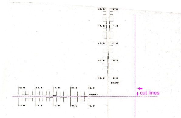

I am having a similar problem. I am printing, then trying to cut a rectangle around image. Roland (sp540) will cut perfect horizontally, but 2" off vertically. I reset to default, but no luck. I had a job wrinkle up and got all jammed, and ever since then have had printing issues.
ocean502
This is how it's cutting.

Fixed
Thanks, I did that with no luck. After speaking to Roland I ran the AUTO from the print cut adj. it was giving me an crop mark error. I shut printer down in both places, and re-ran the auto, this time successful. I ran print cut test again and wa la! :thankyou::thankyou:
