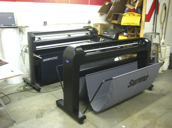

We tried everything tape, lights on, lights off, shining a flashlight on the mark and even sanding with 400. Sometimes it would find the marks, somtimes it would find three out of four, sometimes if you kept sending the same file it would find them, sometimes it would not ever find them. Sometimes it would find them then cut off. The machine was fusterating and wasted more time and material than putting the stuff back into the Roland to cut it.
this is how we fixed ours.
