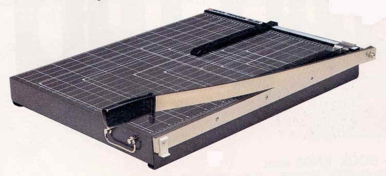

A4 seems like it would be pretty quick work with a ruler and knife on the short cuts. How thick of a coro sheet?
Thinner stuff could be cut clean with a guillotine cutter (the type the teacher used to threaten us with in elementary school).
We just did a 110 single sided 18"x 24"s and 55 20"x 12" double sided coro signs in about 2 hours including mounting. 1 man and the new guy learning how to do it.
