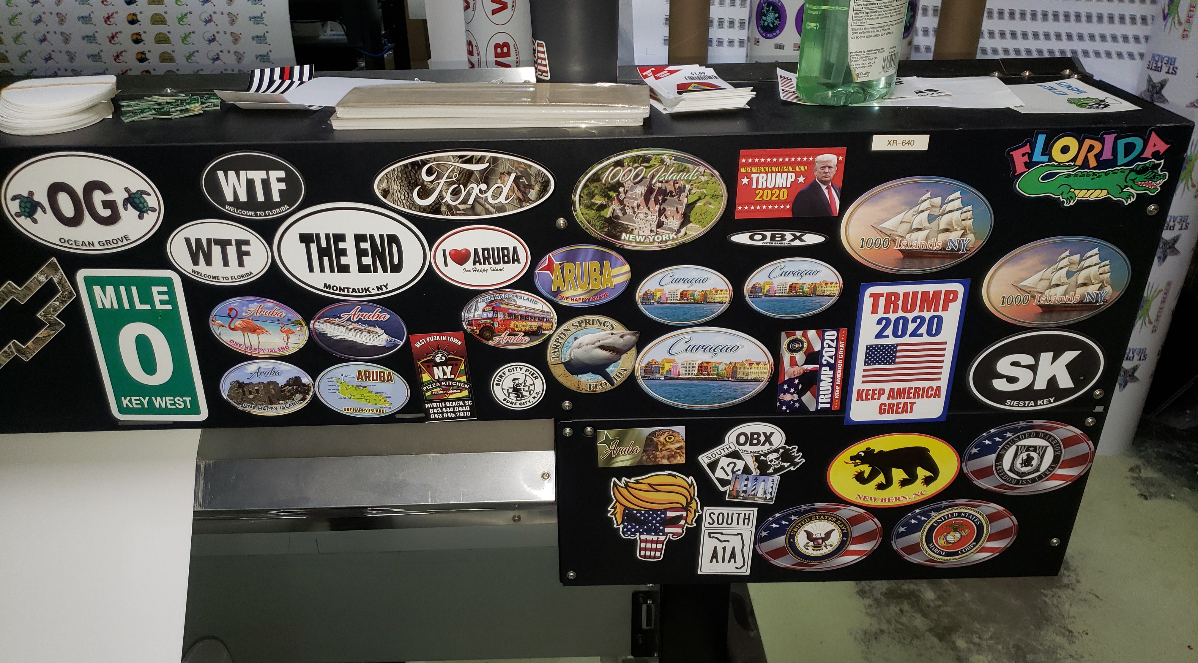

Cant agree with Don McCormick 100%.
I print directly to the magnetic material with a Roland and they are not Fuzzy (see samples in photo attached) and I only loose less than 20 individule pieces. I get a good 600 - 3.5×5.0 magnets from a 30" × 50' roll. I cut them all on a Graphtec FC2250.

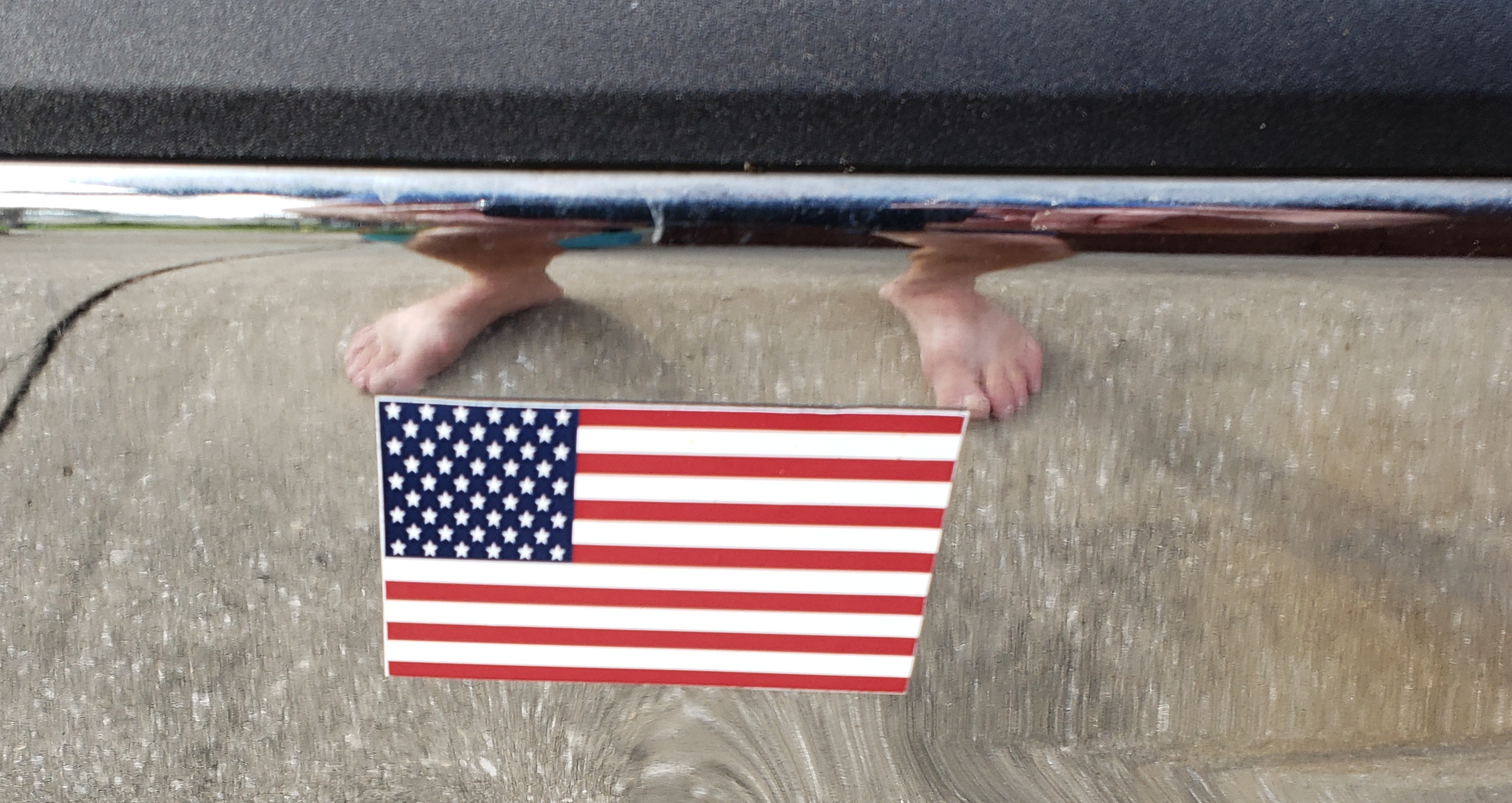

How long would they last on vehicles? I worry the ink will fade or get scuffed without laminating?
I have an American Flag Magnet on my truck now.
Approxmatly 16 months old, still looks good.

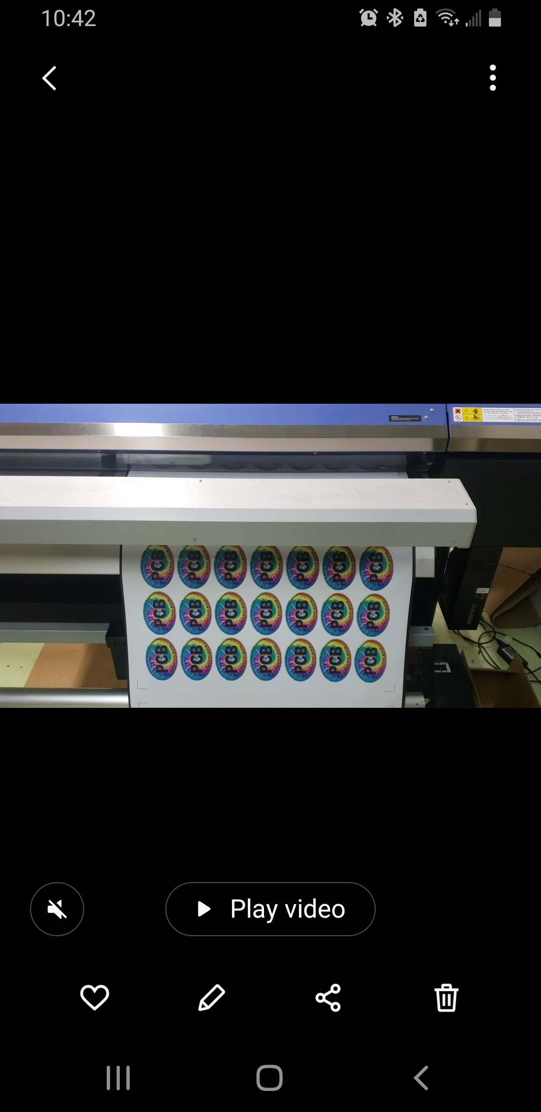

The Roland XR 640 printing magnet material
Roll to Roll. 250 piece run
