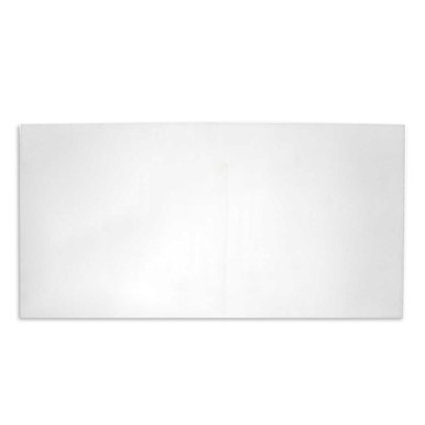

We use this and like it a lot. We have 2 of them.

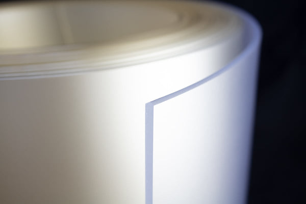

Got a couple 4x8 in this stuff...not exactly sure what it is, fairly hard, has shiner side down...best we have used so far...we rarely used the grid on the old mats we had and the shiny clear mats that came on the rolls roller table did not self heal very well for how soft they were...got a 60x96 roll of same stuff in back room still waiting for me to build a wider table...

I think it is the same thing I use.. UHMW I think is the name of it. The only issue is that over time with many many cuts in the surface it starts to dry out and small white pieces start coming off. I noticed it a few weeks back in my premask and then I realized why I was having so many issues of debris getting stuck under my laminate. That was with swiffering and using an air gun to clean surface... I flipped the board to the shiny side and laminating is debris free once again.

Will this work on a light table?
