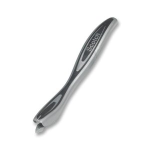

Here's what I use:
http://www.3m.com/brands/scotch/cutters/index.html
It's gift wrap cutter, not what it's intended for obviously, but you can get one at wal-mart for a couple bucks. I use it all the time for cutting the backer without cutting the vinyl and it does an awesome job.
I've also heard that you can use a seam ripper. http://www.amazon.com/Dritz-Seam-Ripper-5-1-2/dp/B0001DSIVY
I read that in Rob Ivers' book but never really tried it. He said to use put the ball against the adhesive of the vinyl and just slide it up and cut. Like I said, never tried that, but the gift wrap cutter works awesome!
laserman70

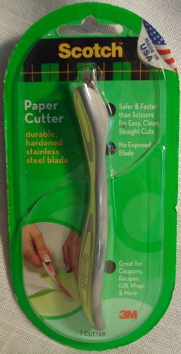

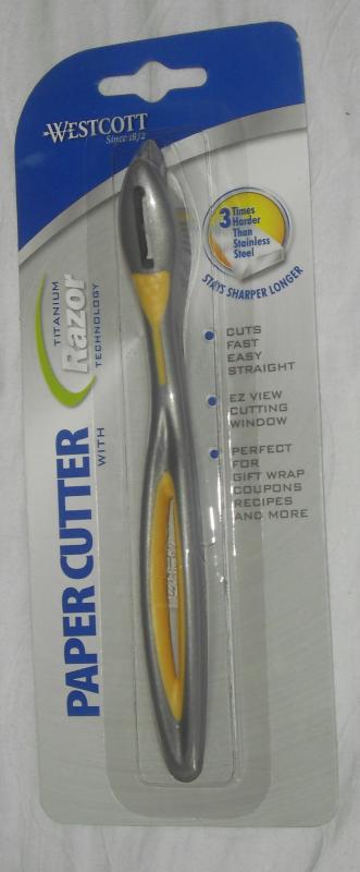

I went looking for the 3M Scotch paper cutter, Wally World didn't have them, so I went to Office Max, they had the Scotch paper cutter for $5.99 ea, and right next to them they had the Westcott brand paper cutter for $3.00 ea. and the Westcott says it has a Titanium blade that lasts 3 times longer than stainless steel.
So, I grabbed several of the Westcott brand paper cutters for $3.00 ea, seamed like a good deal and anytime I have an opportunity to NOT buy from 3M is a good thing!
I hope this info can help someone else?
:thumb:

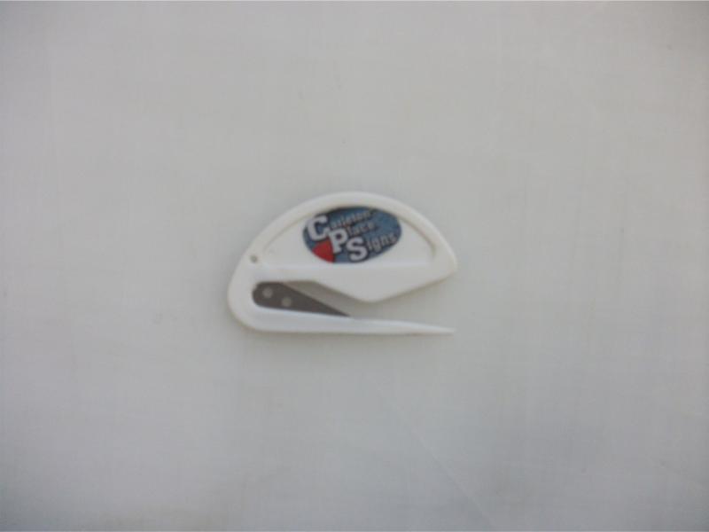

Well, I've been using a little plastic envelope opener for years and it's awesome. And about $1 each,lol. I can take a picture of it when I get to the shop if you want to see it.
