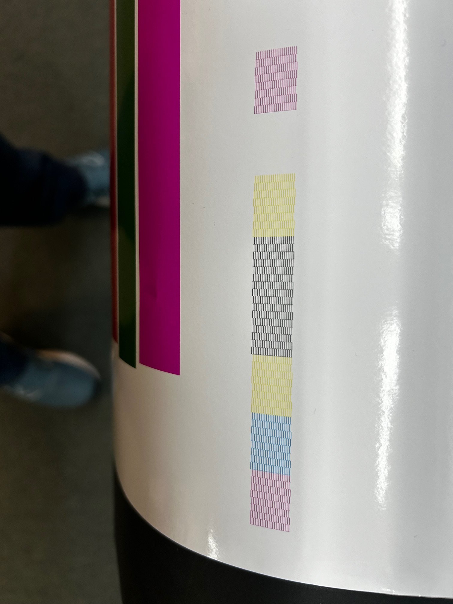

Posting a pic of the test print. One cyan channel is completely out. On Friday I ran a test and about half the nozzles were not firing, then I soaked the heads all weekend.
This morning there is nothing. I printed 4 stripes to see how bad it would be and surprisingly the prints are acceptable, but not comfortable printing anything that requires a close color match.
Any ideas what is happening here?

Check first the cyan damper what Zoogee suggested. If you have ink inside the damper then check the capping. Most of the times when you loose a channel is the capping. Your print test looks like a Mimaki CJV150/CJV300. Mimaki's capping is notorious for the poor sealing, that is why I replace the capping every 6 month. To test the capping, disconnect the vacuum line from the pump and using a syringe try to pull ink while the printhead is in park position. Don't forget to open all the ink valves from the service menu before pulling the ink.
If the ink is coming out without bubbles, then the next offender is the vacuum pump, but if your printer is CJV150/CJV300 the pump should last quite a long time.
A similar issue happened to me after I replaced (twice) the capping with low quality ones bought from Aliexpress. Since then I am buying from Digiprint Supplies.

If it is just the single channel I'd guess bad head, controller board or cable from board to head. Swapping cable from one channel to another is a good way of ruling out the printhead as the issue.

You're getting air from somewhere. Check the connection going to your waste pump. If it's pulling air from there it will cause this to happen. Just had the same issue on a CJV300.

Just soaking the printhead will not solve the nozzles blockage. Replace the capping. It is also recommended to do a capping position adjustment if you use a different brand or capping shape. To save your time and ink, it is also a good idea to confirm that the new capping seals well before starting to clean the printhead. Check my post from 7th May 2024 how to do it.
Just a heads-up: some of the non-original cappings have a bigger third hole plug that can prevent the capping sitting in the right position. You can reuse the old one if it is in good shape.
