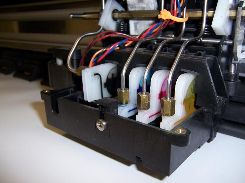

could somebody please look at the picture and tell me - are my dampers supposed to be full, or filled to the center of the cross marks?
(falcon outdoor jr.)

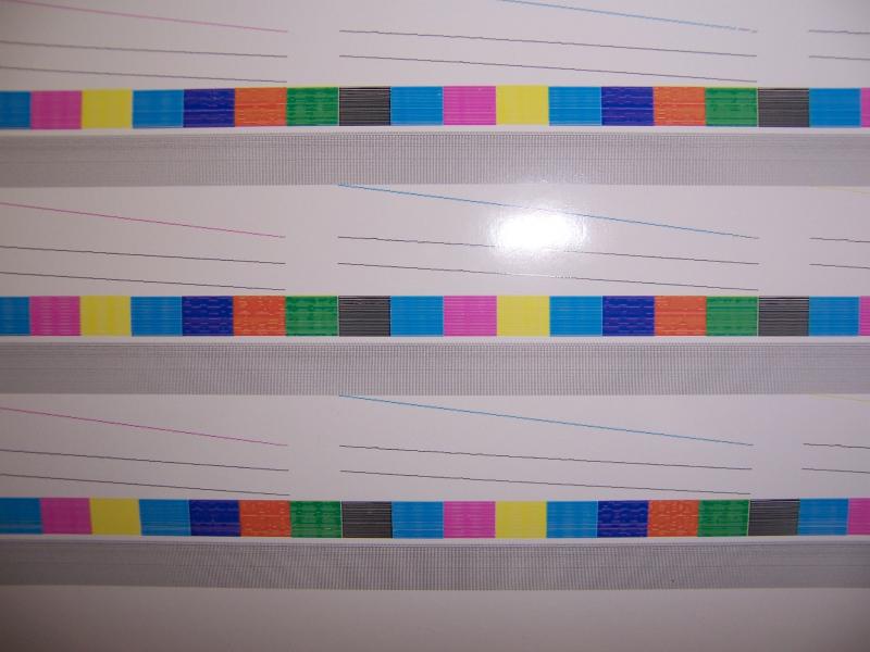

my output is a little light and grainey and i'm trying to evaluate. Nozzle test isnt horrendous, but seems to show nothing missing. i put a wedge under the carts, and i also ran a fill cycle and a multitude of cleaning cycles.any advice would be greatly appreciated, thanks.

AUTO-FX

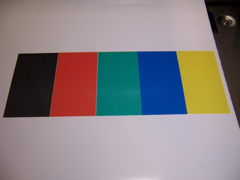

hmm. that's what i was afraid of. i'm thinking "ink starvation" and when i saw the dampers only half full i said bingo. but , as i watch it print, they remain consistently at half. man, i dont get it. prints perfectly yet look at the coverage? like 720 is 360 !I'll tell ya, I struggle with this printer on EVERY job to get desirable results, with a fair amount of success, but this is getting old.

Looks like either heat setting problem or a profile problem to me.
What is your heater set at and what media are you printing on?
I have a fair amount of fighting with mine also, dont get discouraged.
My next printer is going to be a Summa. No liquid ink issues at all with them.

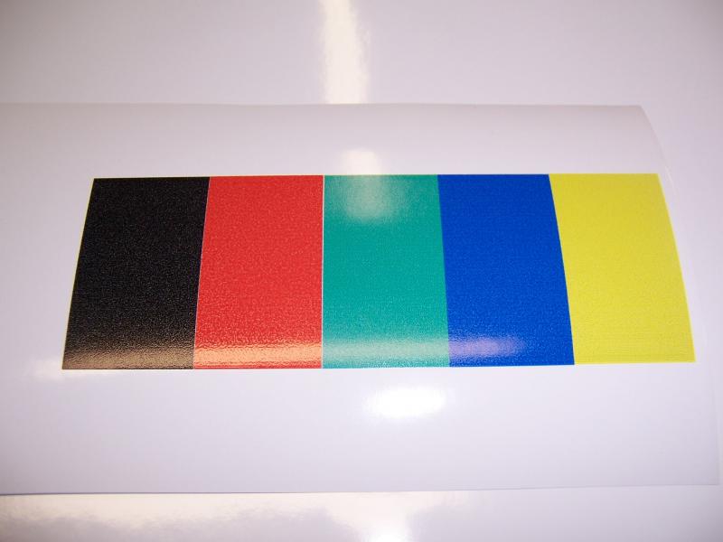

it does look like a profile issue in the picture but that isnt the best picture either. i'll put up another. i tried reprinting some decals with known good profiles and output and compared them with samples i saved. they arent nearly as nice. not even acceptable.

how old are the dampers? ink starvation could also occur if your damper screens are clogged. they're inexpensive enough to simply swap out as a test, if you've got no other ideas.

Signage, the nozzle check ( shown above) is okay - just "weak". I have a nozzle check print from when i purchased the printer, so I do have something to compare it to. I bought this pre-owned machine last feb. so i dont know how long since anything has been replaced. I will replace the dampers and see if that helps.
