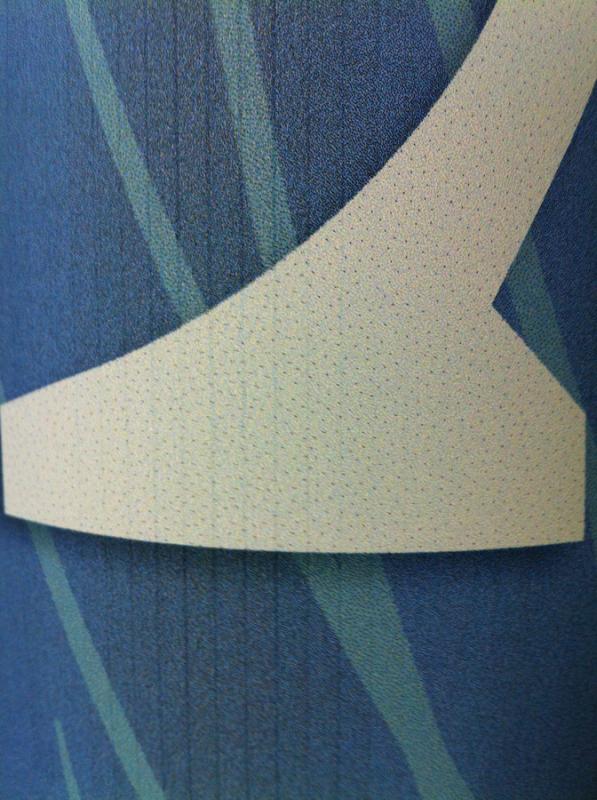

My DJ 5500ps UV threw a 5016 code (reseat printhead) code last week. It was a little over a year old and had maybe 400ml through it. I just bought a new printhead that was NOT expired - had till December or so I think. Now, I get these dark bands about every six inches. The more passes the printer's set to the less they can been seen but they're still visible, just less. They're only on the display/button side and fade towards the ink tank side (Facing the printer - Heavier on the right and almost nonexistent on the left).
I guess it could be the print head but I'm sure the place I bought it from is going to say it's not. Just wondering if anyone's come across this.

The black dots is from it being a bitmap, try printing a raw eps file and see if the white area still leaves black dots
This is an eps file that's from the ad agency I've been print for since '98. Their files are always very good.
Since these posters are viewed at a distance, I've always printed them at 300 dpi. There was never an issue and it should make no difference.
It's the printhead. I tried to print one of the built-in sample prints, one solid color bar for each color, and the black bar only printed a half inch then ran out of ink.
vladio
Thnx for the input. I did a nozzle test and the new black print head was a train wreck. Over half weren't firing. I also did the solid color line test and the black ink dropped out a quarter do the way through. I should have a replacement here tomorrow. Thanks again!
