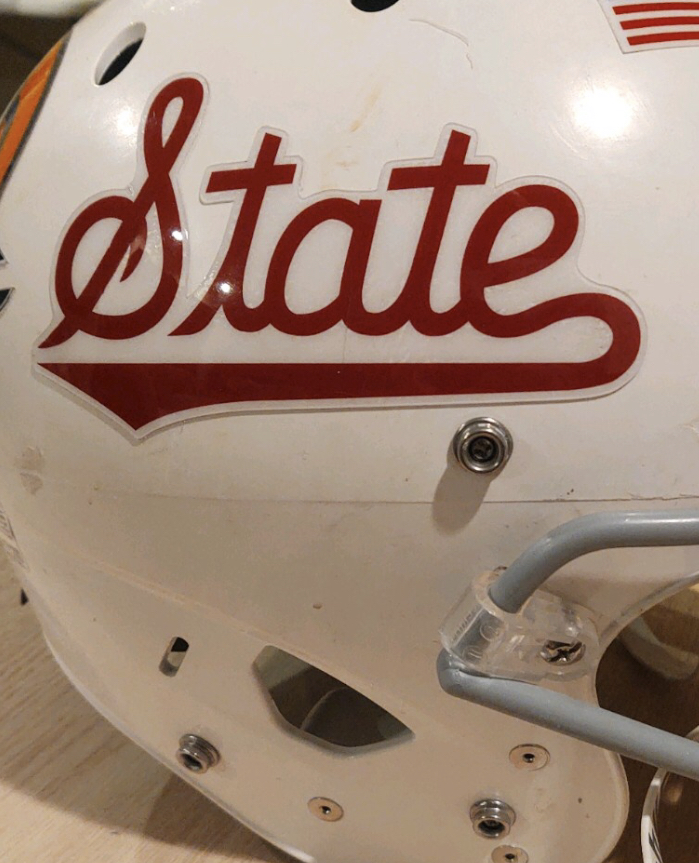

Hey guys, I am making a set of Mississippi State football helmet decals for a customer and the burgundy color I just purchased is not as dark as I would like and not dark enough to send out to him. (See pictures to see color difference between mine and the authentic decals). My question is, what do you guys recommend to darken this color? Do you recommend just to double print the burgundy, or o you have a spectratone color combo in mind that might do the job?
Hope to hear everyone's input,
Will

Bulldogs Maroon should be PMS 505 C from a google search. Quick check shows a close match with Brick Red overprinting Peacock Blue for that value.
May not be perfect match but you can see other combos using the Omega color build finder application. Mine is older and doesn't include that newer Dark Cardinal color Gerber released several years ago
ego198
you should check spectatrone book to see the most exact match..double pirnting same colour always darken as well..but best to check spectatrone book. good luck
