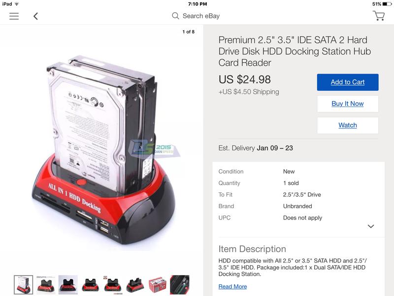

i bought a hard drive docking unit a few years back. this is how I back all my stuff up AND when I fix peoples computers I can put their hardrives in it and pull all their stuff off of it. its also great for putting hardrives in that have spyware and removing it with ease
