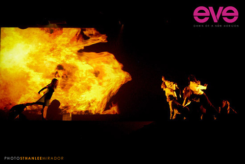

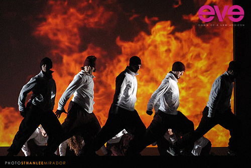

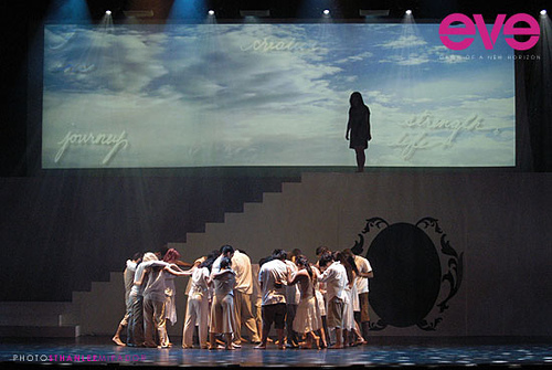

I did a show back in 07' I faced the same issue. Decided it was easiest to project the backdrop on to a large screen fromt he back. Then we were able to change the sceens at will. The back drop then can become what ever time of day or night or season you need. I can send you the contact of the guy who put it all together.
