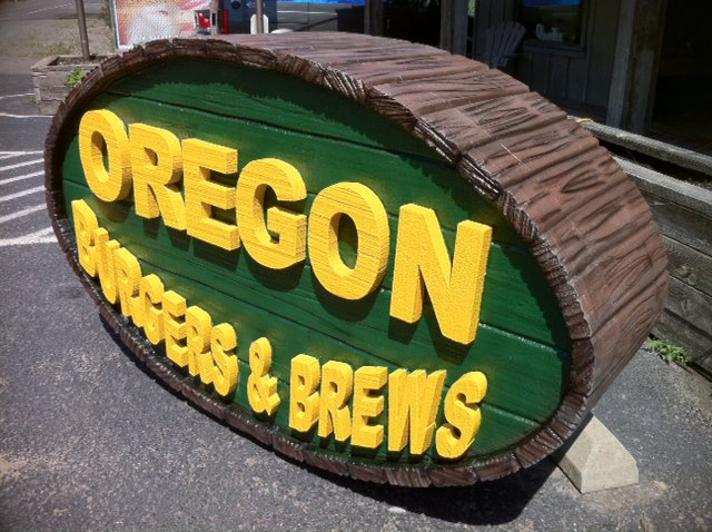

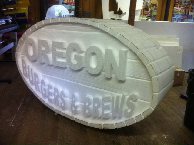

For the shops that only do stickers on a sub-straights, this sign could have been done. Put it on some di-bond printed two sides and charge the customer $500-$900 depending on where you are located. I did this in Full 3D and made it look like a attraction to stop cars. I charge for your skills plus a sign that works. This sign was for the Oregon Coast, sits up on a like 5 post wrapped in large ships rope. Giving it a Ships dock feel. all i did was the sign did not instal and this sign cost over $3800. Only took a day to make. Yes my customers know that it may only take me 8-10 Hrs. They also know I am the only one that can do what I do this fast. When there sign goes up people ask about there sign. This proving there sign is working to get people inside there business.

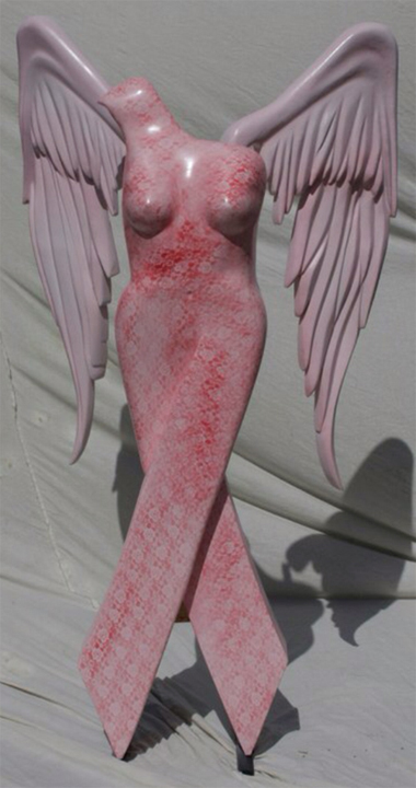

Well Like I said I do this Part Time. My manufacturing company for the Rogue Roller (sign making machine) takes a lot of my time. Plus I do my work shops for helping other sign shops break the out of there mold. so when I do get in the studio I must say I am in Heaven here on earth. I just finished up a series of Statues for breast cancer awareness. It was my own design and was a donation of 75 6'4" Statues. To help ladies get checkups. they sold at auctions around the us from $900-$4300 each. I have found by helping others it only brings me more work and my name gets out farther and farther. I get people all over the world asking me to do a sign for them. Not because I'm popular because my work is different every time and never the same.

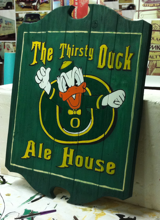

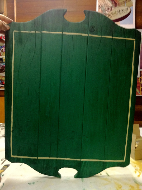

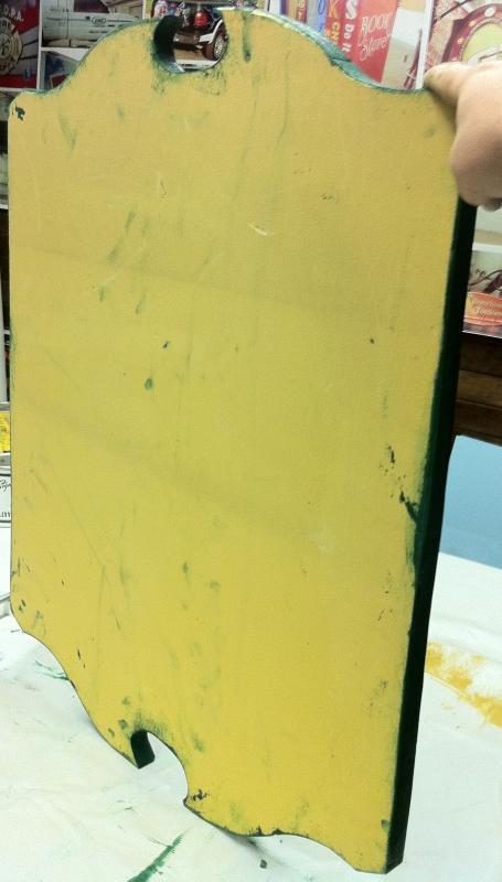

I did this sign for a client on Sign-Foam 15 LBS. there were no tools other then a jig saw sand paper and paint brushes. A sign like this can make a sign shop get noticed. If one practices you can do a sign like this in under a hour and a half. A sign like this should go for no less then $500 tops $750. so you see i don't always do full 3D. Although I do think this sign would be really cool with the duck coming out of the sign. LOL

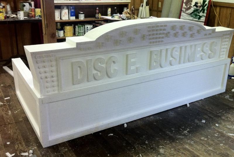

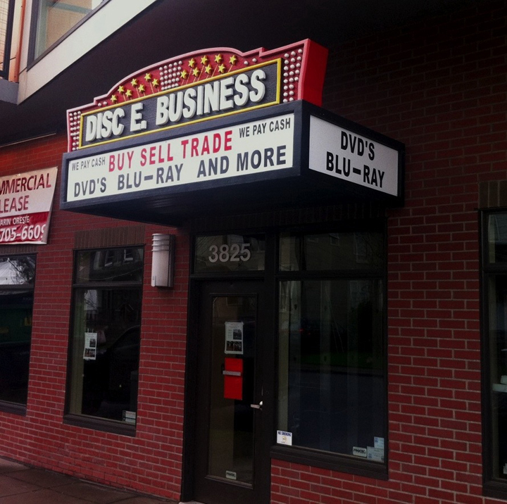

Here is a good example of how I use my vinyl cutter Graf-t 7000 The panels on the sign are di-bone with vinyl. so as his industry changes he too can change his sign. the store front had these metal industrial I-beams coming out to make up the awning. (they would hold a elephant) But the store fronts had no place to put a sign other then graphics in the window. My marque Slid onto the awning making it look like the building was made for his store. Plus it really gave it a retro look. The City of Portland Loved it and the landlord could not believe how well it made his new building look. The client could not have ben more happy.

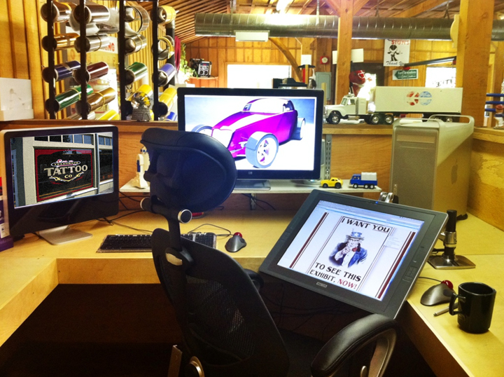

I do use a computer to design My work out. I sketch on a Wacom screen and use what ever software I need for the job that I need to design. Plus I do have a wide format printer and vinyl cutters. I feel one needs these to stay in todays market. I just don't only use them alone day in and day out hoping to stay ahead of the other sign shops. Here is a pic of my design center there is more to it but this is what I use mainly.

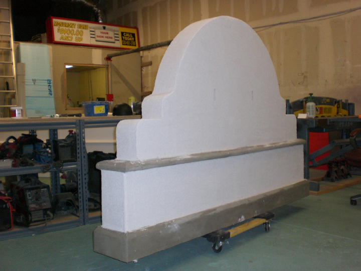

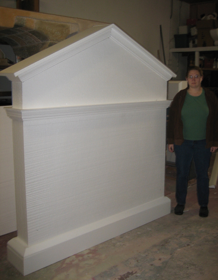

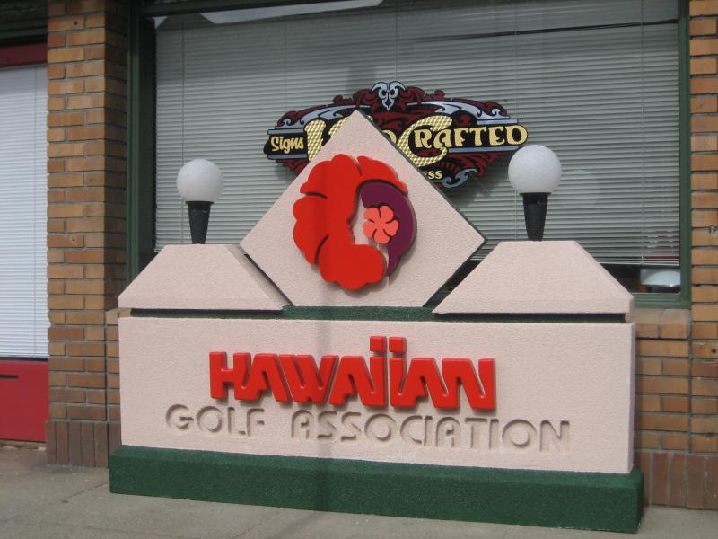

Like I said earlier this is how I got into the 3D world. Monument Signs here is my first 3 that I did. It paid wee but I found the challenge was soon gone.

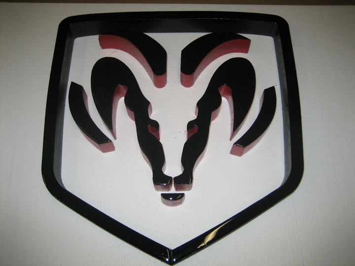

Thought this might help the ones that are thinking I should try some 3D. This is a simple Wall hanging I put together It is made of Blue Foam Board (Local Hardware Store) I made a simple Hotwire table, cut the design in vinyl place on the foam. Cut to the edge of the vinyl. Paint it using house hold latex paint 3 coats. than take some fiberglass resin and poor into the top of your design for a doming effect. (Poor slow allowing the resin to go to the edge it will stop and will not flow down the sides) Let cure and show it to your local car dealership don't be surprised whey you don't come home with it.
