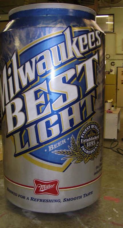

I'm really clueless, Roller. I'm a newbie, and never made a sign close to any of those. Could you kind of layout the process?
Buy foam, depending upon needed depth stack it/glue it, and what? How do you get the foam baby butt smooth? Sand it? Like what are good cheap things to coat the foam to be baby butt smooth?

Well.. I'm kind of at a cross roads. I now know where to get EPS foam, and how to glue it together. I'm now wondering what I should use to make it smooth, and ready to paint. I know you can use water based paint to paint it, but I am just not wanting all kinds of tiny foam bubbles.. I'd rather have it smooth like a baby's butt. I'm also curious how the paint holds up in the foam.. I did read where you can just apply a light coat of ...(I forget the name of the stuff atm.) I guess I will try that, and see how smooth it gets it.

Sorry if I missed your question Justin, Call Industrial Polymers In Houston TX.
The product you want to use is Stiro Spray 1000 (you can brush it on, roll-it, or spray it with a sheetrock hopper gun for applying texture to walls from Harbor Freight. the product will self level and give you a glass finish. apply 3-4 coats.
