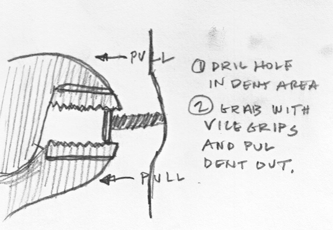

Cut a rectangle around damaged area. Pull off vinyl and clean glue off. Mask off area with transfer paper. Sandpaper area and drill several small (1/8") holes where dent is. Insert screw in hole and slowly pull damaged surface even with face. Do this in several places until dent is close to being flat again. Use Bondo just in drill holes and push into holes using putty knife so it mushroomes on inside of metal. Keep Bondo to a minimum and wipe off excess right away. Use the putty knife to keep Bondo flat on surface. After Bondo dries hard sand area flat and prime area with spray can of Zinsser primer (Home Depot).
Remove tape and transfer paper and put new piece of matching vinyl.
