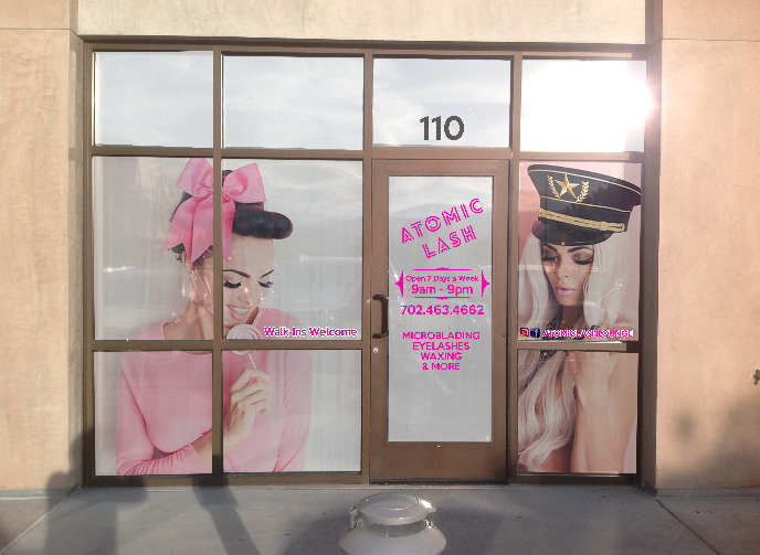

I turn down the opacity to 60 percent on my window designs while leaving everything else normal. It helps give a more realistic idea of outcome and I also have printed 5 x5 samples with my name and number on it that I give to the customers too as a point of reference.
