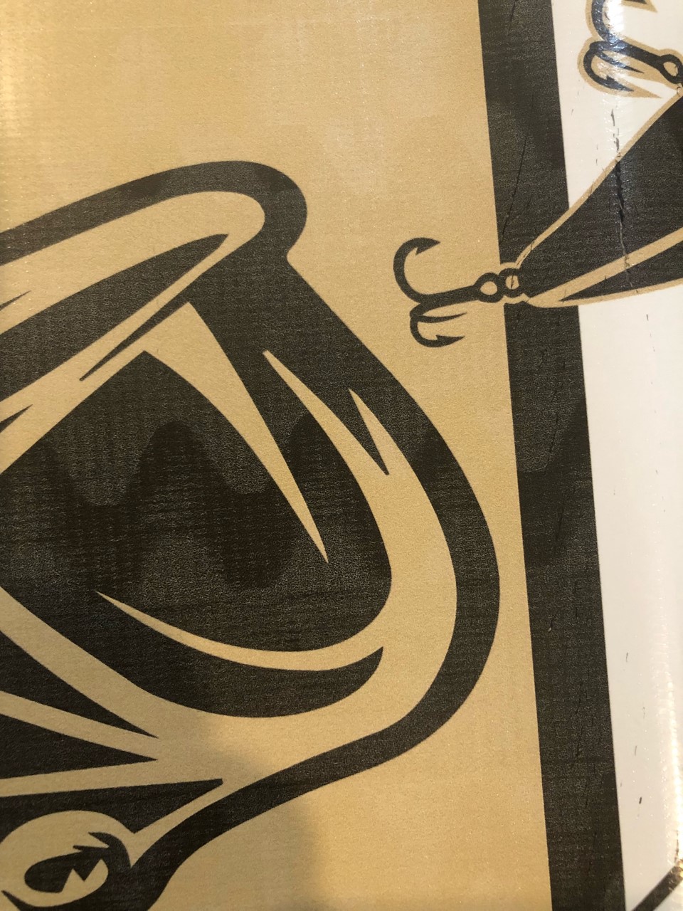

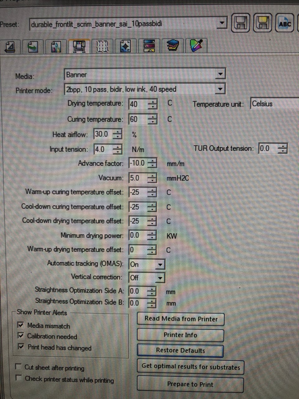

Today for some reason I cannot print a banner without it looking faded and "chalky" like. There is even sections that have like a wavy print on them that seems to be from the heater coils or something....I don't print many banners but the last time I did they turned out fine. I wish I could remember any setting changes I may have made to make those banners print normal the last time. Anyways, I am not very advanced with my machine but everything else seems to print just fine. I use flexi and the production manager for that. For banners, I have my preset set to durable frontlit scrim banner/10pass. dry temp: 40C , Curing temp 60C , which is what it automatically goes to when I preset to frontlit banner. I check everything I can think of to make sure the rip and production manager are the same settings. So is there anything I can change in my settings to make a normal looking banner???? thumbnail_image0.jpg thumbnail_image0.jpg
This roll of banner is likely plasticizer-contaminated. To check this, clean a defined area with Isopropyl alcohol, mark the cleaned area with a sharpie marker, and then print a job that extends through the cleaned area. You are likely to learn that the cleaned area prints besutifally, while the un-cleaned area looks like your pic. Get a fresh roll of media or clean the current roll would be your options.
Alright, cleaned the printheads multiple times. I cleaned off the banner material like you suggested. The banners still come out drab color. But if I put in gloss vinyl the colors are what they should be. I tried putting in a different banner material and still drab colors. If you see anything in my setting from my first picture I should change let me know. I have tried boosting up the cure temp to 80. same thing

I decided to just not use the banner preset in production manager and just use what I typically use for gloss vinyl. Seems to be working fine doing that. Colors match the screen and appear normal. I talked to a technician at Fellers and he said that is common practice. Thanks for all your help guys. I'm sure I will be back.....
