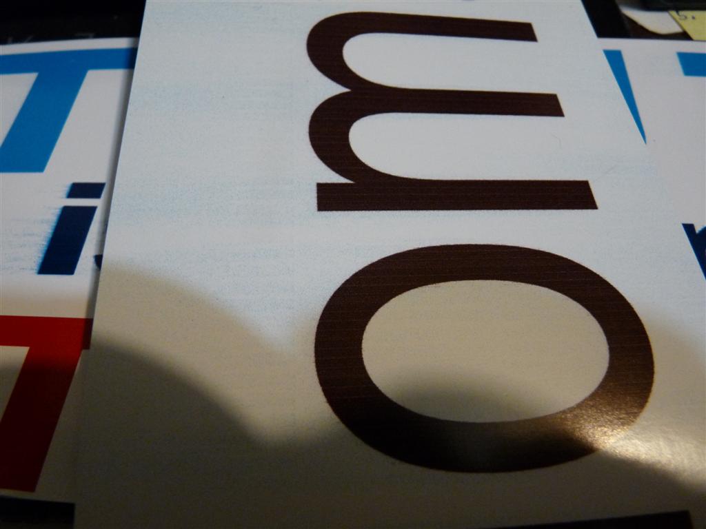

I am starting to get some strange output from my printer. Almost looks like some kind of over spray making wide bands of just wisp of a shadow. Is there any place that has sample pictures of unusual outputs to compare with as a diagnostic tool?

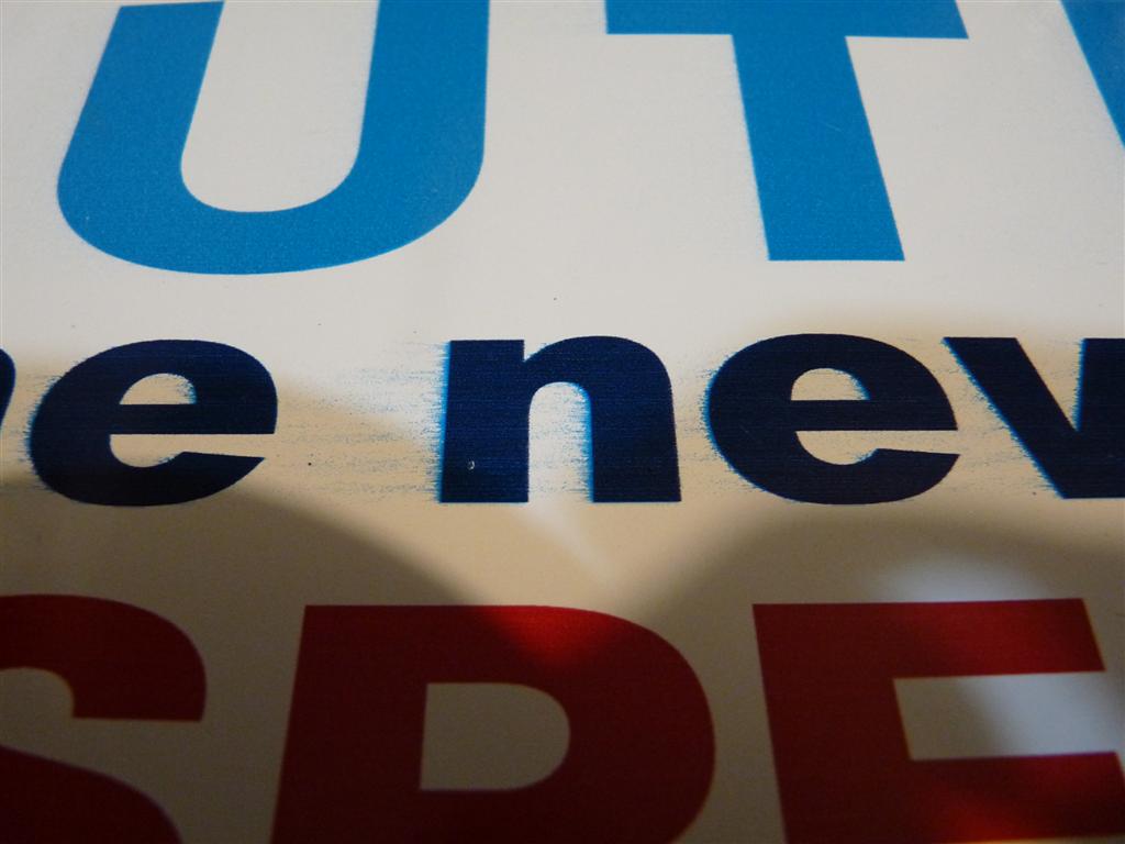

OK, I got my replacement camera cable, here are a couple of photos. In one you can clearly see how the blues are streaking out of the letters, but reds seem to be fine. In the other you can see the wide bands of blue shading. It's hardly noticeable but there should not be anything there except white.
FYI, the black lettering with the shading issue was printed vertically, so the printing was being done perpendicular to the wording.

Unfortunately that is a pretty clear sign the head is fried. You could try replacing the head cables and cleaning the cable terminals and that might fix the issue but it's rare. How old is the head?

I learned something today. I contacted Mutoh and sent a copy of my printer output. They normally don't respond to end users but I got a reply.
"If it’s only one color (which it is) I would think the alignments got knocked out of place somehow, or maybe the ink is expired."
I was under the impression that eco-solvent ink would last indefinitely, but apparently it does have an expiration date. I checked one of the cartridges and it does have an expiration date right on there. I never notice it before. The Cyan is the problem color, almost empty, and well past it's expiration date so I ordered a new one. I am hoping the fresh ink will solve the issue.
