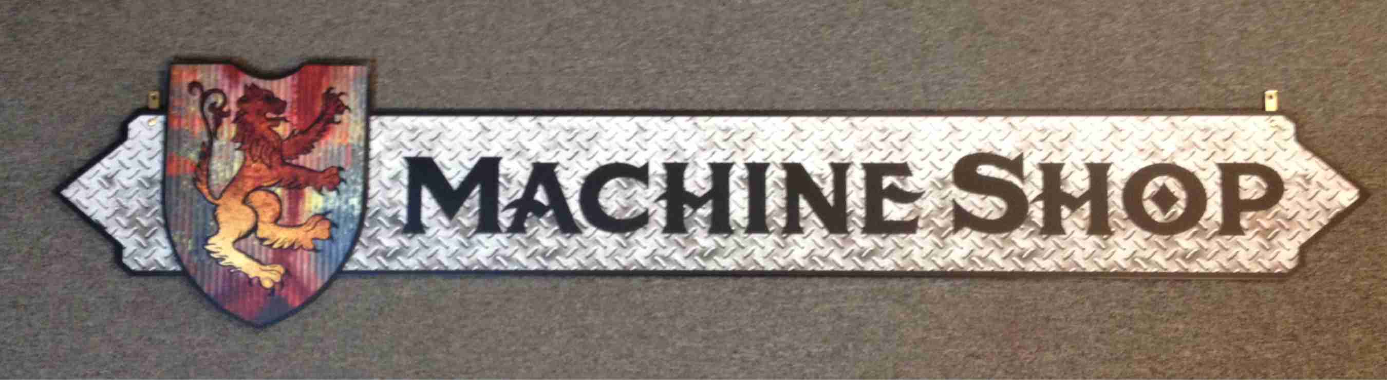

Billct2
Here's a printed one I did using a fill that has an aged diamond plate look.
