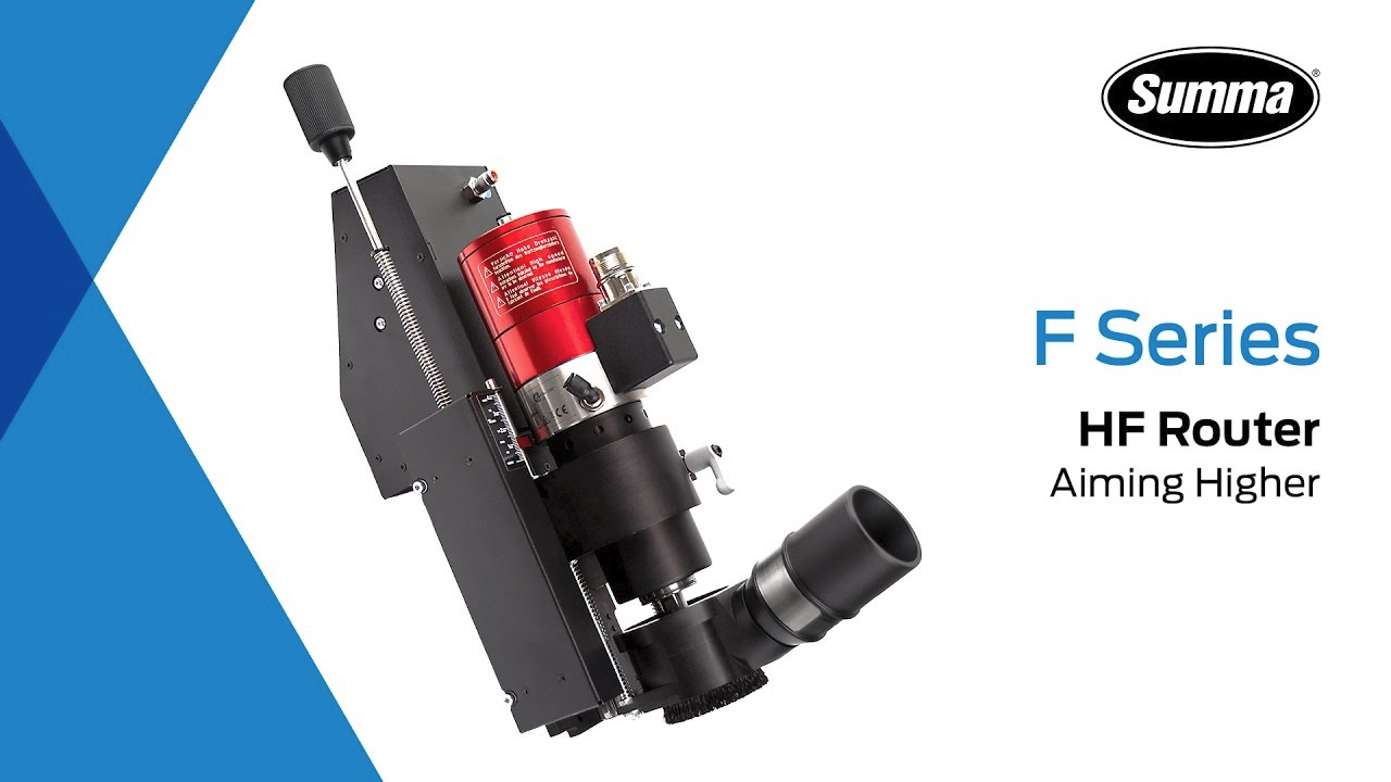

The Summa Router is very limiting, just understand that if your production levels increase.
I don't feel we need a laser at the moment. Why do you think the Summa is limiting? 90% of our business is roll to roll. We just don't want to outsource anymore.
Christian @ 2CT Media
The router on the Summa is limiting. It's effective but underpowered compared to the spindles on the other machines meaning it will be slower and have a lower cut quality in some scenarios.
Your initial list was long, if your primary use case is roll stock not fabric the summa is excellent, if you need to do everything and it's a be all machine, I would look at your other options. It was not discussed but what is your budget?
balstestrat
Problem Solver
You guys do also know there is the "real" router as well, right? With real spindle and more power.
The "dremel" one is meant for people who rarely need it but need it.
Yes it costs more money to buy the real one but it's there.
