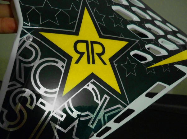

Word of advice on cutting, outsource it. I do and it litterally takes less than 7mins per kit to cut.
FYI, I never waste time using my new Summa as there is a much quicker way ;)
