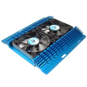

I think you should consider..........
a HD cooler.

The Raptors don't put off as much heat as you would think. So as long as you have good case fans you should be golden.
