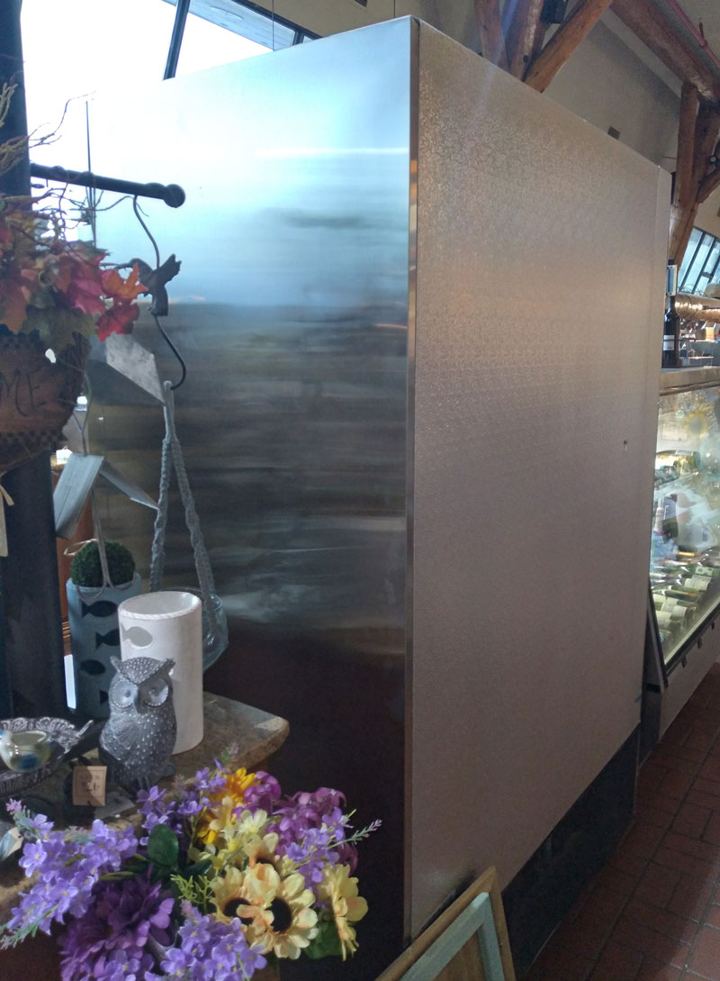

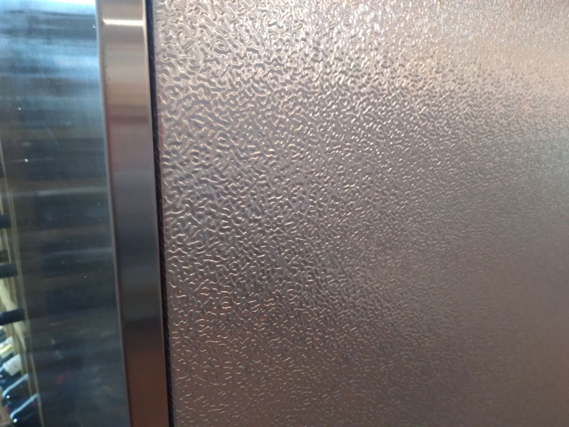

I'm bidding on a similar project, customer wants printed vinyl wrapped on three sides of a refrigerator unit. Two sides are smooth and the back is textured, see pics. Is this feasible with printed vinyl, or will it look weird with the texture or not bond well?
I would use cast vinyl on the sides - skip the back, nothing will stick to that for long.
