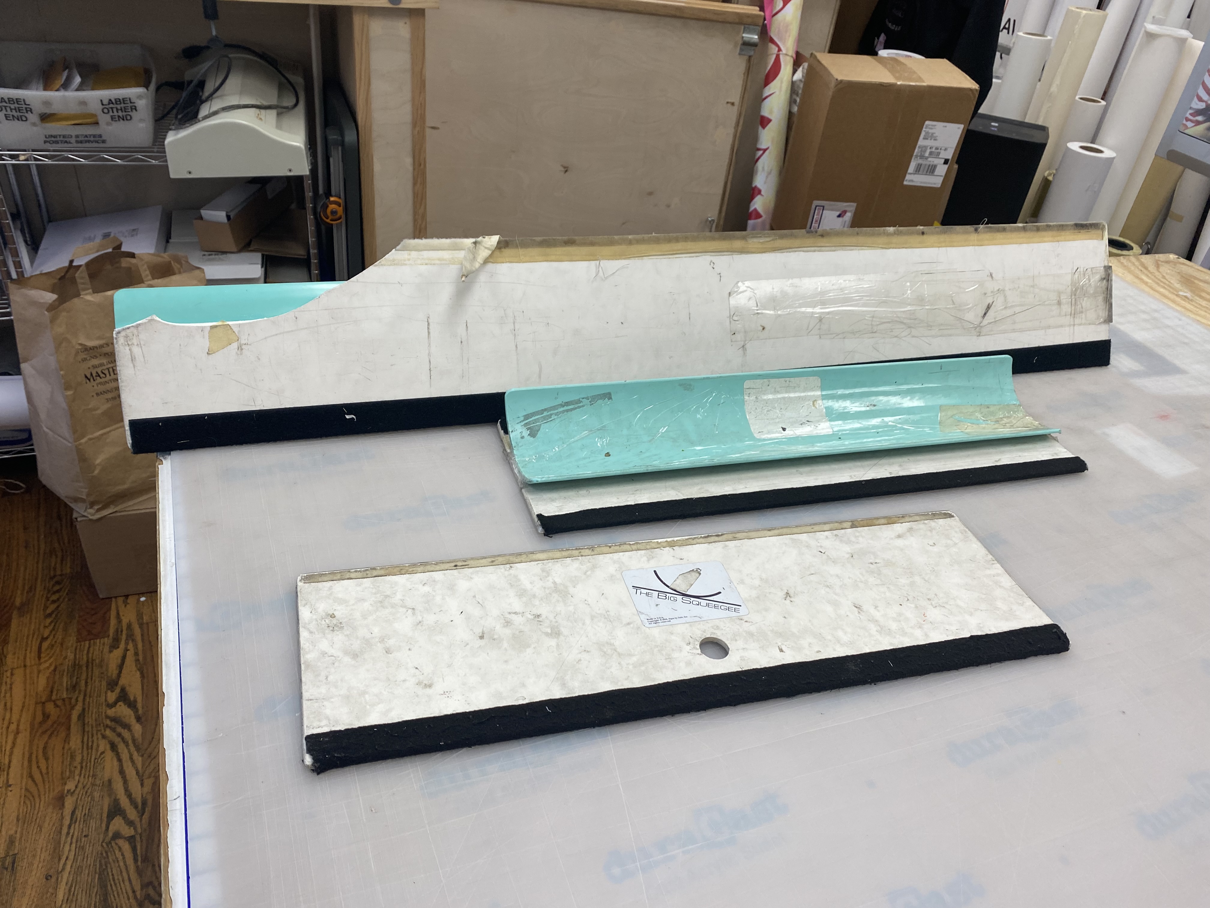

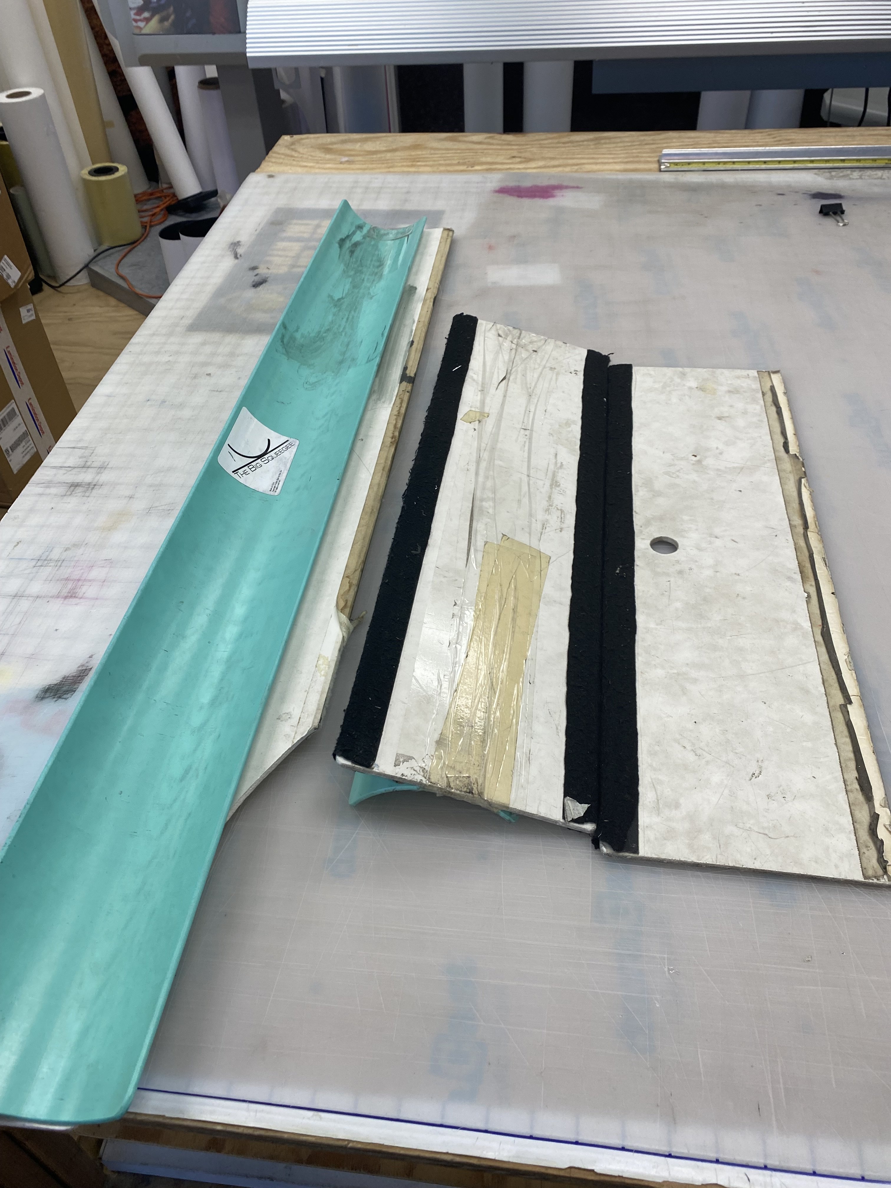

I've had these squeegee's since 08' They are taped, broken and sorry looking. But we used them everyday. I also have an aluminum squeegie that we don't use, cause our table SUCKS! Was flat for the first 6 months. But this building was a bar for 50 years and the moisture in the air is crazy.
