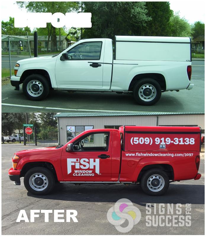

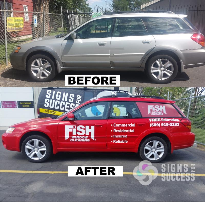

We did these two recently with Avery cardinal red and they went great. White lettering is overlay
As long as your car is one solid color, and you do not have any seams, you shouldn't notice any color shifts. If you have for example a two tone paint job, especially with both dark and light colors, you might notice the red will look slightly different on each color. Same as if you do a seam and overlap. The overlap area will have a slight color shift. Quite a few colors are like that, so you just have to plan accordingly when laying out the car
