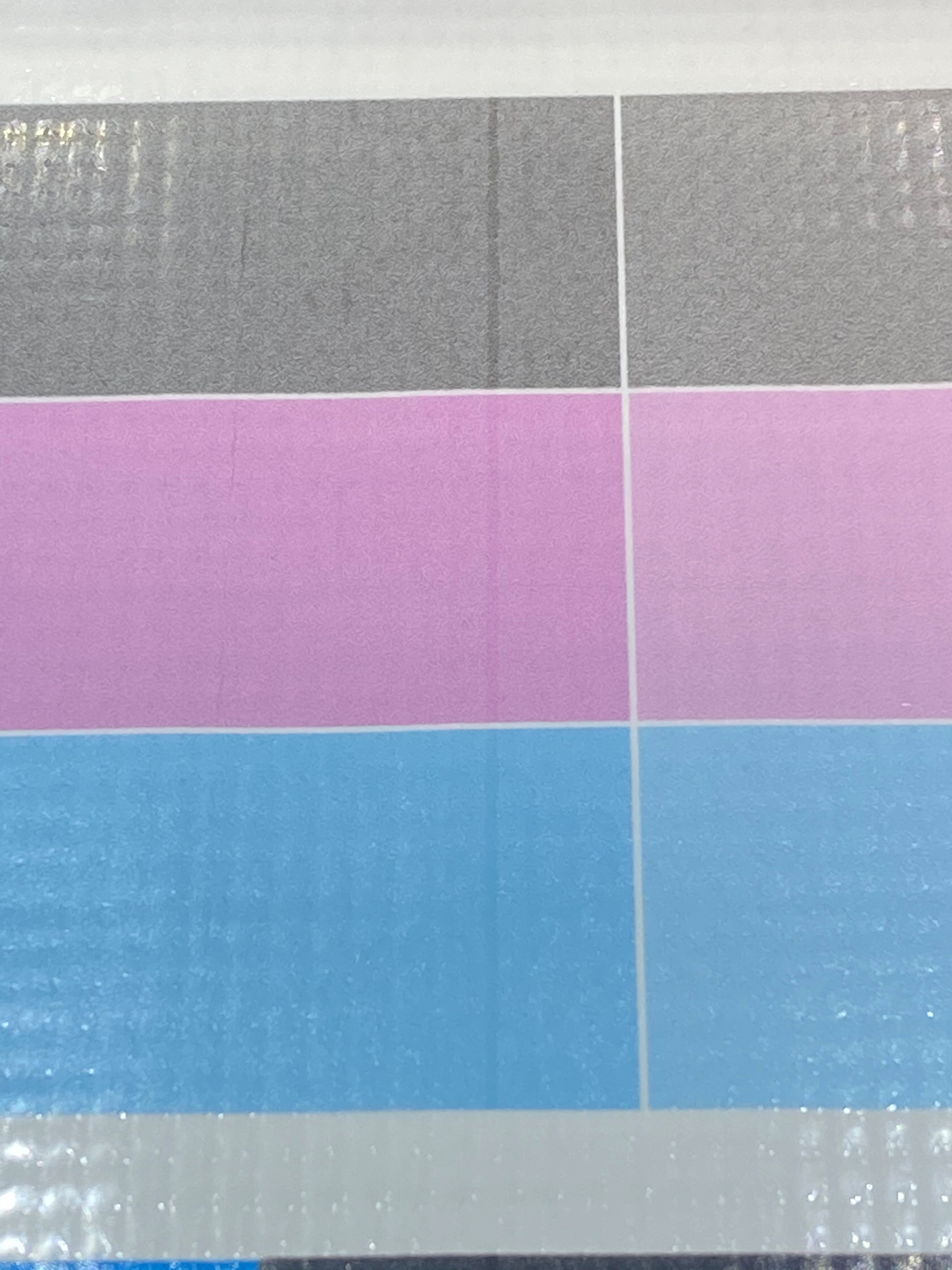

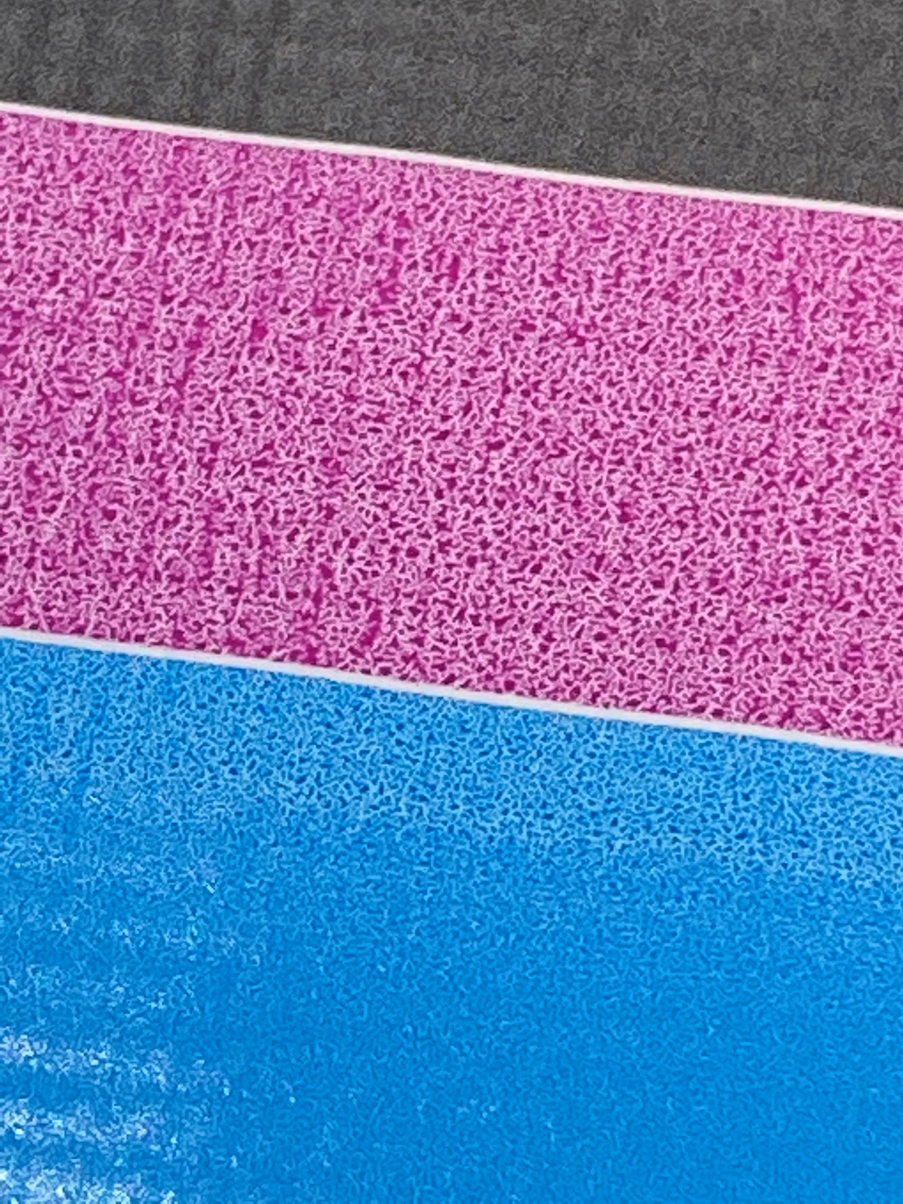

I ordered a roll of forward wound Duratex 13oz gloss banner material from Grimco. This is what its doing. Is this an issue with the material? Not having an issue with anything else.

It is likely that the media print surface is contaminated.
To test this, clean a defined area with Isopropyl Alcohol and a towel, and mark the cleaned area with a sharpie marking pen. Next, print a job that extends through the cleaned area well into the non-cleaned area. After printing, inspect both areas. If you see that the cleaned area looks good, you have proven the presence of contaminates on the media. With PVC medias like banner, the contaminates are commonly high concentrations of plasticizers that have migrated to the print surface over time. Options would be to replace the roll with a newer fresher roll, or clean it.

I assumed so but wanted another opinion. Constantly have problems with all the duratex stuff from Grimco. Anyone have a goto favorite I can try thats reasonably priced?
