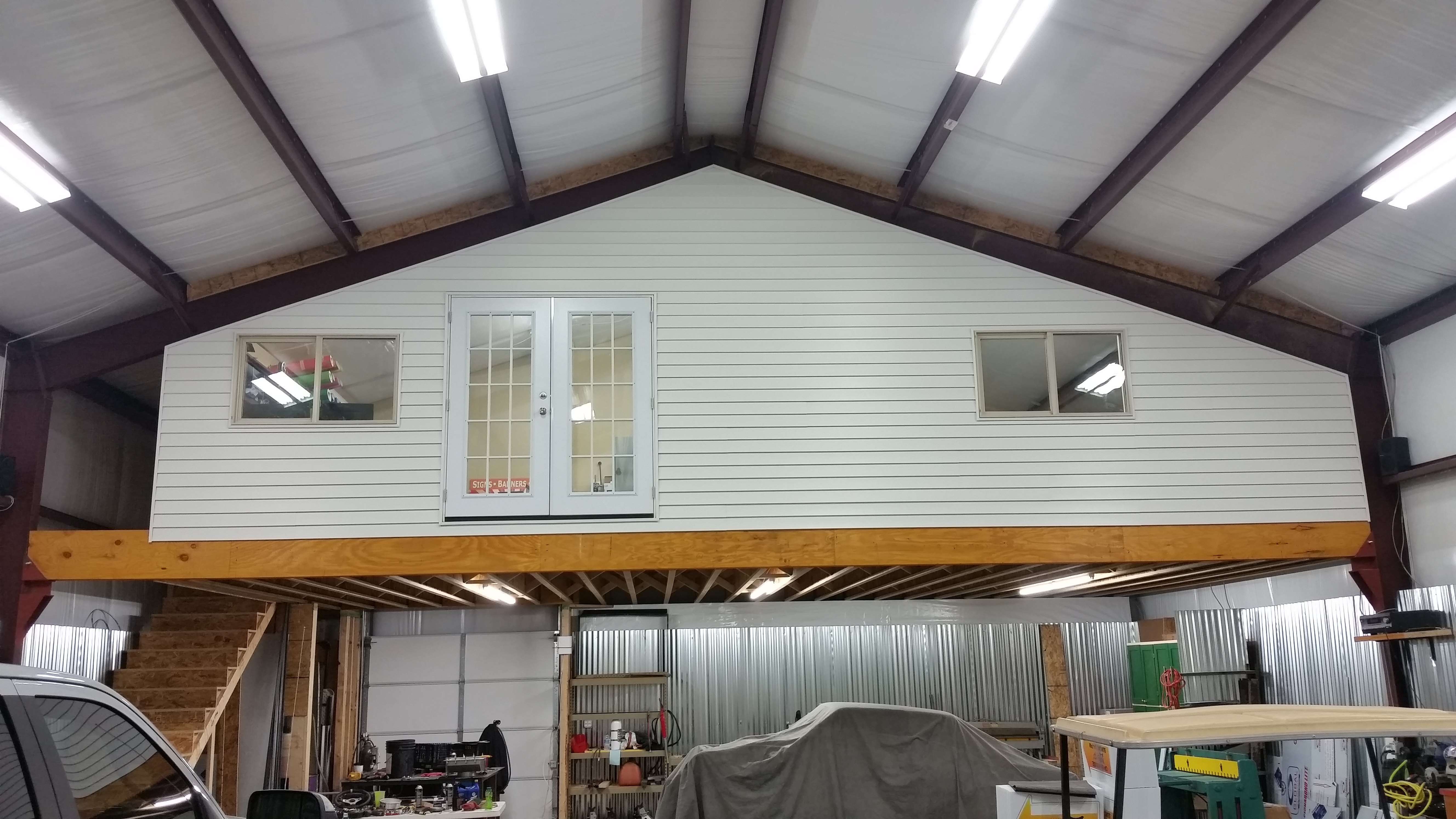

I work out of a 40x60x16 steel building at my house. The building is not just for sign stuff tho. I have a 20x35 closed in mezzanine office on 1 end of it..

Very nice and looks organized. At my age, I'd hate to be taking all that stuff up and down those little stairs. Here's hoping you put an elevator in some day soon..... or have a cheap grunt person on staff for that stuff.

You have the exact setup I want to built. The variant is I will isolate everything.
