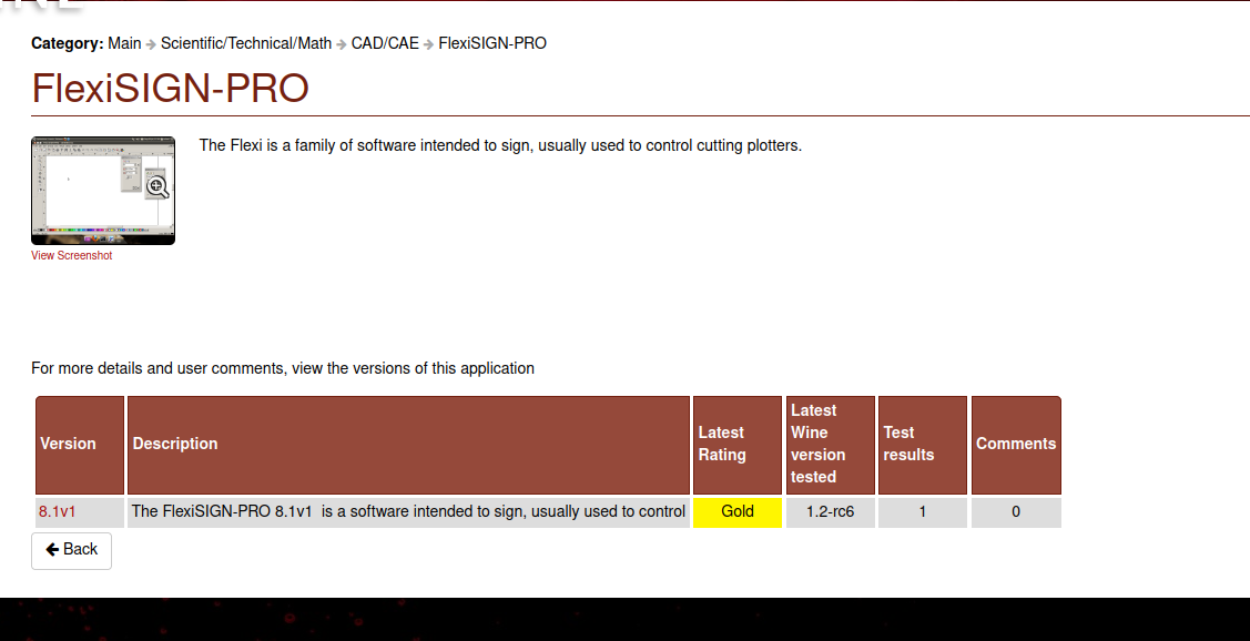

However, to avoid that issue of hardware resources, WINE would have been the best possible method, but just don't know the compatibility of Flexi 10 as 8.1 was the only one that I could find. There would be very little difference between a truly native client and using this compatibility layer to handle it. It's akin to Rosetta on Mac (Mac does have a commercial version of WINE available for it, but I digress), but that only handles different arches on the same OS (x86_64 on M1 mac programs etc) (which WINE can do that as well, how people have gotten GIMP and Inkscape to run on Android).
However, the reason why it wasn't on top is due to what I saw attached. That's the only testing that has been done and it doesn't apply to Flexi 10.
