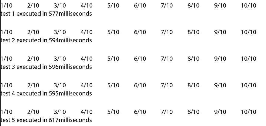

I wrote a benchmark script for Illustrator that can be used to compare performances on different computers, (open illustrator and drag and drop an an artboard)
  • Illustrator Benchmark.zip
