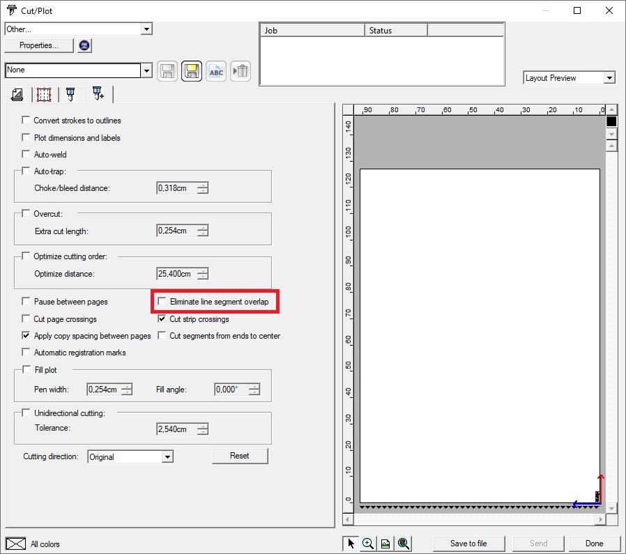

Im trying to cut A4 pieces using my flat bed cutter. Each A4 is white edge so no need for a bleed. Normally id add a cut contour then step and repeat with a space.
As its white there is no need for a space. So I step and repeat with 0mm. Is there a way to merge the cutlines so it doesnt cut twice along the same path?Ive tried every combine tool and nothing seems to work.

There is an option in the cut dialog to avoid cutting double lines. Unfortunately here is late evening, but I can check it tomorrow.
FrankW
Try "eliminate line segment overlap" in the "Advanced"-Tab of the Print/Cut-Dialog (see attached screendump).
This is from Flexi 21. Should work (not absolutely shure).

cmykburnley
I shall try that, thank you!
Be awesome if it could actually be done in flexi itself at the point of export. Rather than running into the rip itself
