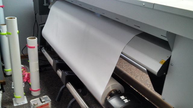

Here are some pictures to illustrate my struggles:
Nothing major to see here, at least nothing you can see from this picture:

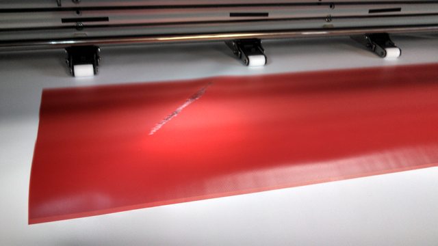

Here's one of the marks, as you can see it is following the "wrinkle" in the media (left side):

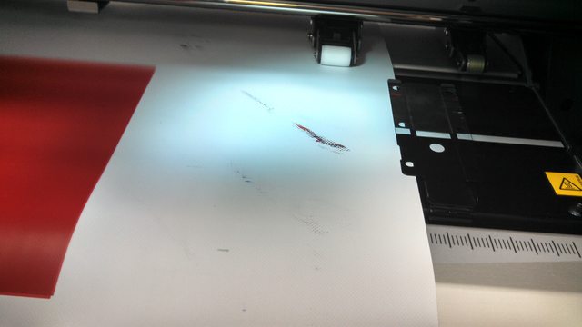

Another mark on the other side (right):

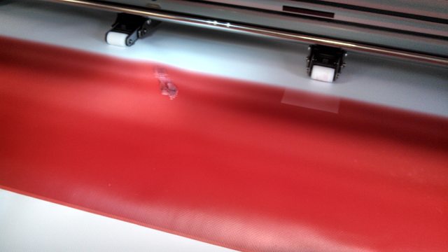

This is outside of the job... but still... grrrr (right side)
