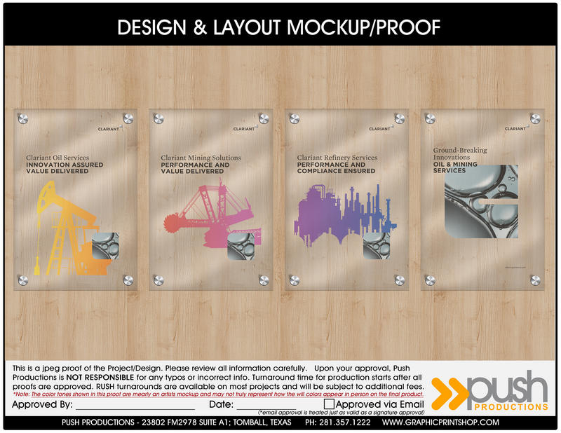

Here is the proof for out client. All of the lettering and images need to be seen through the glass.(adhered the vinyl to the back of the glass).

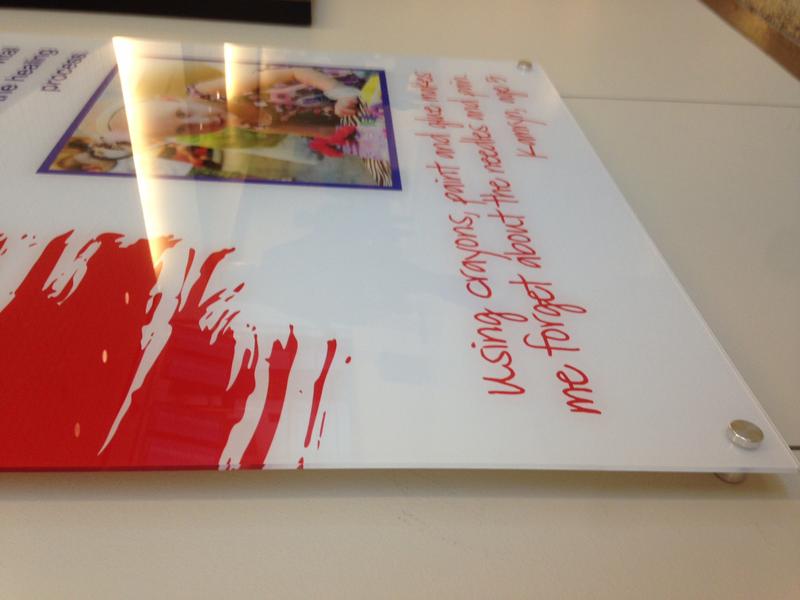

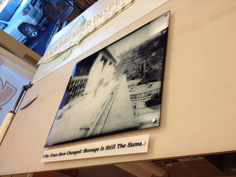

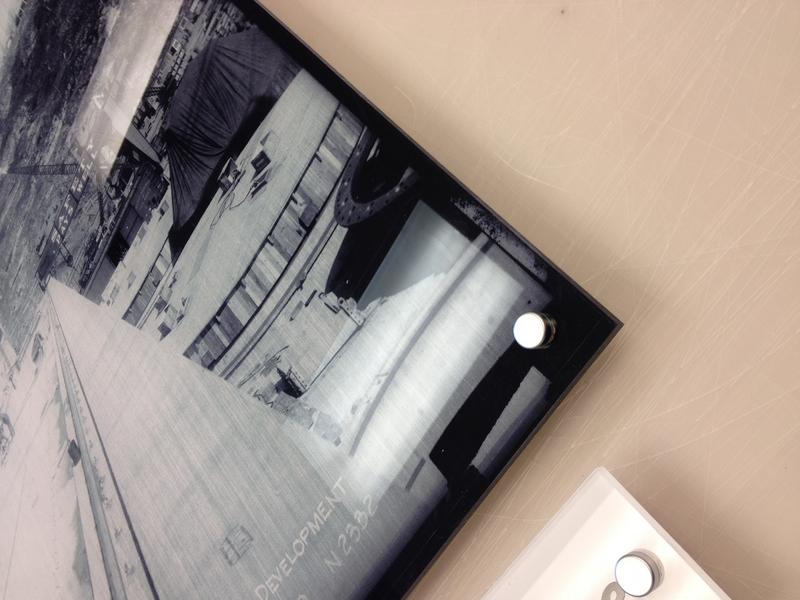

Here is one we just did
lgroth
I use 3M IJ8150 - 2mil optically clear printable vinyl for back mounted graphics, I usually try to run it on our flatbed and flood with white, but when I can't I just laminate it with a white psa vinyl with clear adhesive. For small ones I'll use something like an Oracal 651 series white vinyl as lam.
gabagoo
In the layout you show, I can see the wood grain through the glass...why would you back it up with white? You won't see the wood grain.
