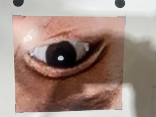

I feel like though that as a designer if I am starting with a digital photograph to turn it into a poster for the proud parents of baseball players that I wouldn't lower the quality of the photo. Why go from a 300 DPI digital photo to a 72 DPI poster. I printed a small section of it and am not impressed. Looks wrong. Hopefully the designer is able to send me a higher quality version. They did a good job on the look of it incorporating the baseball picture with a cool background and the school logo, but the print I did doesn't look right to me.

I feel like though that as a designer if I am starting with a digital photograph to turn it into a poster for the proud parents of baseball players that I wouldn't lower the quality of the photo. Why go from a 300 DPI digital photo to a 72 DPI poster. I printed a small section of it and am not impressed. Looks wrong. Hopefully the designer is able to send me a higher quality version. They did a good job on the look of it incorporating the baseball picture with a cool background and the school logo, but the print I did doesn't look right to me. View attachment 170274
You're right for sure. They most certainly have the full resolution file that will print better but either they don't know how to save a print ready file at full resolution or their software only allows them to create PNGs. It's fairly common these days for people to be using a free online design tool that only saves 72(ppi) pngs but since this is a school, I'd assume they used Adobe or Corel. I'd ask them what software they used to design in and if they can send a PDF, with downsampling images turned off, instead. That way you should get the full resolution image with any vector graphics that may be in the file as well.
My guess is that the school asked the Web design class to design the posters and they're just used to saving as PNGs. If that's the case, tell them to save as a PDF or a TIFF at 100-300 ppi.

You do realize that posters, signs and most other things we are producing are meant to be viewed from a normal distance. When I first started painting signs, we were told, flowers are meant to be smelled, not signs. If the viewer is that close to a sign or picture, that they can only see the eyeball like in the example shown, they are entirely TOO close to the subject matter. Step back and see what it is like at a normal viewing distance. Otherwise, they should take a real photograph with a proper camera and have it developed at the size they want.
