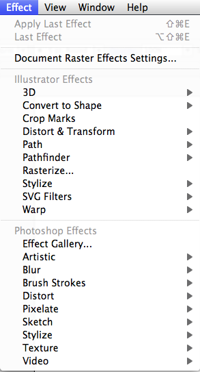

Also be sure to set the resolution of your raster effects to a large amount. 200-300 is fine for business cards [document raster effect settings]
