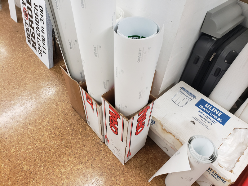

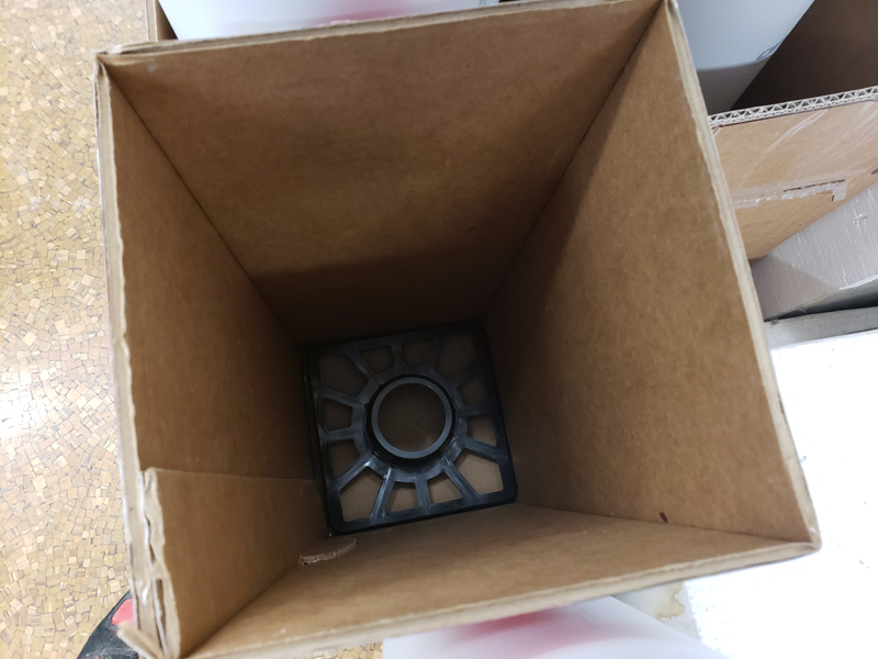

For drying prints, we just use these and leave the prints standing on end loosely rolled for 24-48 hours. We lay them out flat to air dry for at least a half-hour before rolling them up. We also run a floor fan and sometimes add a half-second print delay for profiles that lay down a lot of ink when feeding onto the take-up reel.
